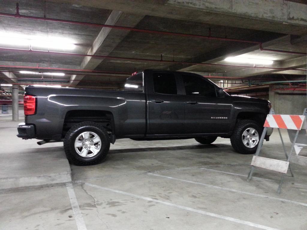

Since then I put a set of cooper 275/70/18 and have no issues
The profile shot is not great because of all the blackness ! but here’s a few
20” rockstars with Nitto Terra Grapplers 265/75/R20’s

I did mine, I put BFG A/T 275/70/18 on it. I love it so far.

I have almost the same truck...same color, wheels, bed length. Did you put the blocks in the back? I'm getting ready to do mine. Your truck looks great!
Thank you. Yes I did the 2" blocks in the back. Ild suggest doing it because without it the truck has the back rake to it. A lot of people say "oh only 2.5 inches?" But believe me more people can tell the difference so far than those who can't
