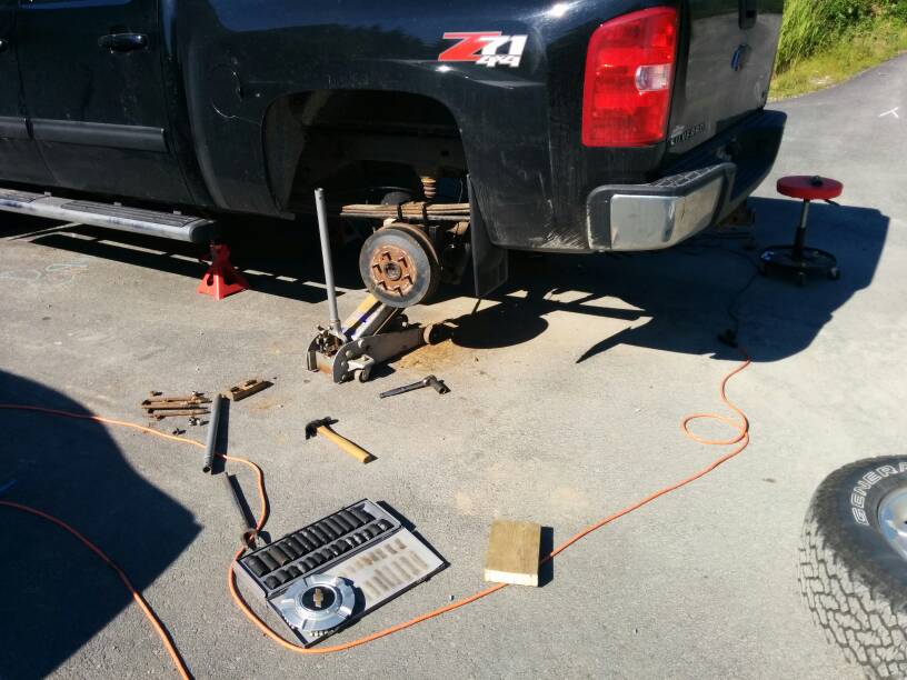

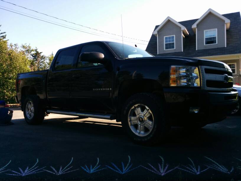

So I did the 2" level a while back. Love the look but the rear always seems a touch lower. I assume its just worn leafs. Also tow a trailer in the summer so the rear is still down some. (yes I use a WD hitch set right)
Anyways, I got some 2" blocks coming to replace the 1" stock. I know its not recommended to stack blocks but what if you put a tack of weld on the blocks? I've read other replies that say if you don't do any off roading you should be fine stacking.
Inform me peeps.
i didnt stack, but i went with 3" replacements on my truck when i did the 2.25" level from ready lift. Takes it back to close to stock rake, but gives the truck an overall slight lift with the combo.
thanks. I'm still torn between the two. Worried the 2 wont be high enough and the 3 will be too much lol.
leaning towards the 3 though.
I would go with the 3" It's what I did too when I put the 2.25 Ready LIft level kit. Gives it a bit of rake and back end doesn't end up sagging when loaded.
  • 5 weeks later...
So if I go with a 2in level and a 2rear block I won't be at my stock rake?. What I want is 2in the front and one inn the rear so I still have some rake

    • Is it an optical illusion in the pic or is the truck really squatting that much horribly?
