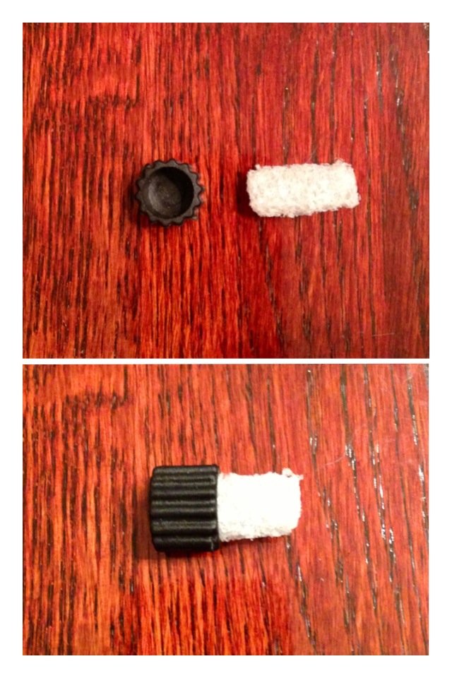

20sierra14 - I misinterpreted your intent, my bad. A few months ago I purchased packing tape, foam, plastic cap, liquid rubber, plastic, and quality cowhide leather all to explore options, the more time past, the more the options and materials increased. I intended to use all those resources, but not having access to grilles, precise mic data (although what you provided was enough), and 82 degree temps today, allowed me to do some yard work and brainstorm a bit more. After the yardwork, I thought waiting to obtain grilles was not fast enough so I began to fabricate what I now call option 14, with the understanding that if this didn't work there were 13 other options that may also work (we still have the cotton balls and tape to fall back on also)
But, when the fabrication was done, I ended with what I believe to be the "best" 2-piece option for the buffeting. This option does not require any cotton or tape, although if tape is used it won't be visible from the outside of the grille. Answer a question, put an index finger in both ears and tell me what you hear? When you post your answer, I will PM you a picture of what I fabricated and tell you what to do.
Give it a test drive and tell folks what you think. I went for the kill shot (best option), if it doesn't work, we go to the next option.
Again I remind folks, it is not the customer responsibility to fix this issue, only mitigate it until a fix is provided

What I fabricated was in essence a "Mic Plug" (MP), look at it as an ear plug for the mic. This was logical and made sense, I laughed when I completed it. The MP is in 2 pieces constructed of foam and a plastic cap. Based on dimensions and specifications of the mic provided by 20sierra14, I found a cap then fabricated a plug. The way it should work; take the plug and place it into the center diameter portion of the mic, flush it with the top. Then take the cap and cover both the plug and the outer portion of the mic, flush to the bottom. What you will end up with is a mic which is effectively plugged and capped. My understanding of ANC is it operates under sound and resonance initiated at the mic, none of which should happen if the mic is plugged and capped. The end result will not degrade over time, I considered this the best option but if it doesn't work there are still 13 other options I can try and as a dependable back-up, the cotton ball and tape. Also, these options can work singularly or in combination.
Now I didn't send this to 20sierra14 but advised him how and what to do as an effective option similar to this one (option 15?). As I sit and write now, I have thought about 2 more options. Since none of the options can work for me, hopefully you guys can benefit from my R & D, something GM can take a page from.
