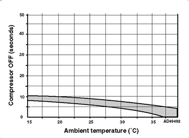

Now, about that compressor cycling chart. Why is it supposed to cycle several times a minute? I know its supposed to cycle when or if the evaporator reaches about 36* to keep it from freezing. Other than that, why other than pressures being too low or too high is it supposed to cycle?
The numbers on the second chart and the numbers I'm getting are quite different. Living in the Houston area where the humidity is rather high (70-80% is faily normal) that charts says at 70% humidity and 90* outside temp the max low side should be 53psi and a max high of 405psi. Really? Normal max high at 405psi? That sounds awfully high and really hard on the entire system. Compared the those numbers I'm way off.

Attached is another chart of general Compressor OFF cycle times vs. ambient temp.
