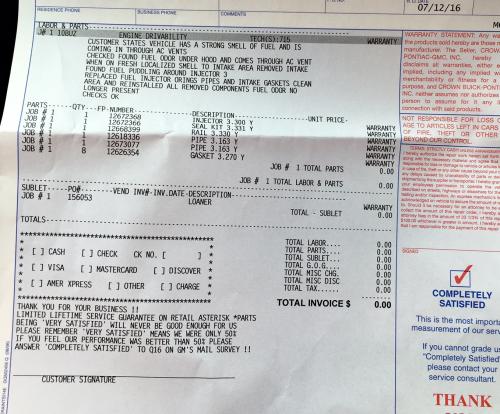

Reymon,
I bought a combustible gas detector off Amazon, made a video of it and emailed to GMC dealer. GM factory rep happened to be there and saw video. They finally gave me the VIP treatment, used the video, bought my gas detector, used the info on the is forum, and fixed the problem.
It is a factory defect with injectors. I'll post pics of the repair and video.
