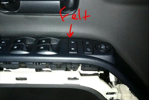

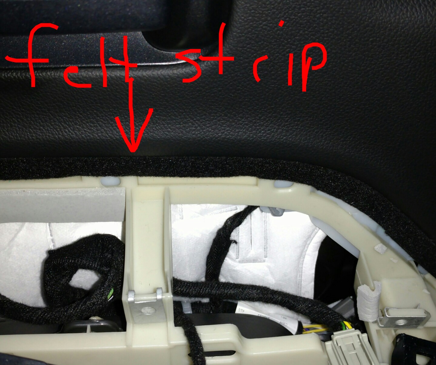

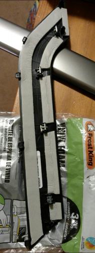

Passenger door rattles fixed (some pics).
After reading through all of these rattle posts I spent the weekend applying what has been done already and coming up with a permanent solution to all the door rattles. I previously fixed the front dash with tape around the clips and removed the black clip from the sunglass holder. Now with the doors taken care of I can say the truck is 99% quiet.
The silver trim and area around the window switches were the main sources of noise.
1. Silver trim, I removed it by pulling with some force straight out. 4 clips hold it in place. Then using 3/16 vinyl foam weather strip I lined the outside. Lastly put gorilla tape over the holes the clips go in to and cut a slit through the tape for the clips to fit through.
2. Where switch trim meets door panel (previous post had a folder ticket jammed in the area). Now that the silver trim is off I unscrewed the four screws holding the piece in place and gently pulled it away from the door. I then used adhesive felt from JoAnn fabric, cut a strip and lined the area where the plastic meets the fake leather (this is where the rattle was coming from). Once the felt was secured and lined up I put the trim back on. The felt looks like it's supposed to be there, if you can even notice it. Tightened the four screws, snapped the silver trim back on and after a long ride and some loud bass music tests no more noise from the door. I did both doors even though the driver side was pretty much quiet from the start.
