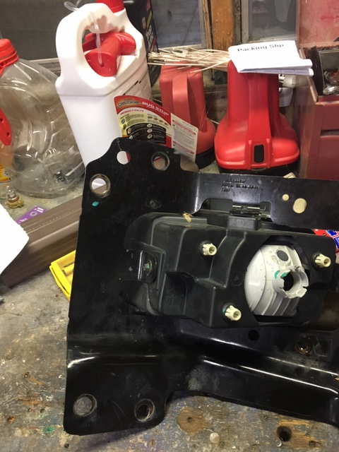

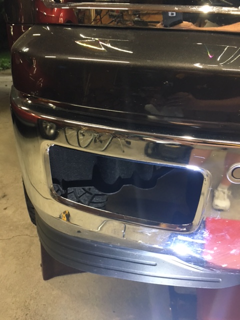

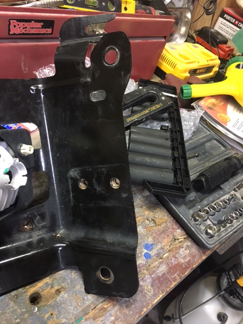

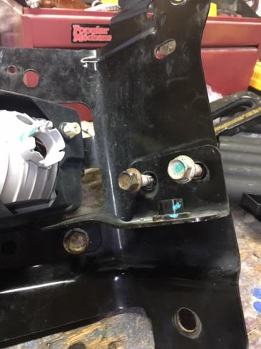

Do not need to remove the bumper, at least not on a 2014 Silverado LTZ crew cab. Just get under the front end. Remove the bolts, maybe 7 or 8. I removed the bottom two screws on the front side of the wheel on the wheel liner and then the one in middle above it to allow room to remove the fog lamp housing. Take the whole thing out. Then you can work on it on the bench. I just replaced the passenger side as it was getting moisture in it. Replaced it with new housing. Bolt it all back in.
No reason to remove the bumperpost-154145-0-56689100-1474773358_thumb.jpgpost-154145-0-56390800-1474773359_thumb.jpgpost-154145-0-55469000-1474773360_thumb.jpgpost-154145-0-42040600-1474773361_thumb.jpg
Thank you for the tip...gave me the confidence to tackle both mine, as they had moisture. You have to be careful not to scratch the bezel for the fog lamp, but they come out the bottom with patience. Even tweaked the alignment of the bumper ends when I was done. Thank you so very much!
