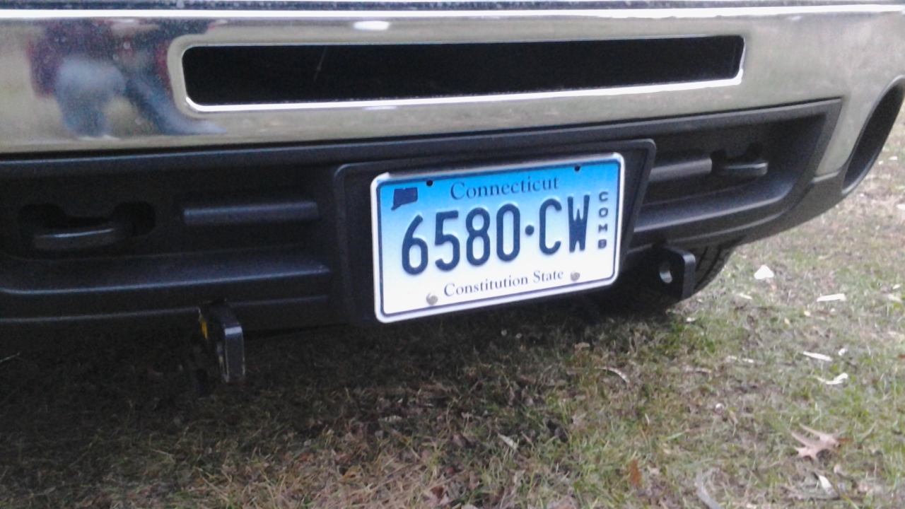

I put a Meyer V Plow on my 2013 Gmc Short Bed Reg Cab
I did put the leveling kit on first , i like the stance better
I did remove the lower valance and cut the plastic bumper extension about 1" wide x 2" high on both sides
Yes I have a plow on mine. If you have the plow prep package with the HD springs, you shouldn't need a leveling kit.
