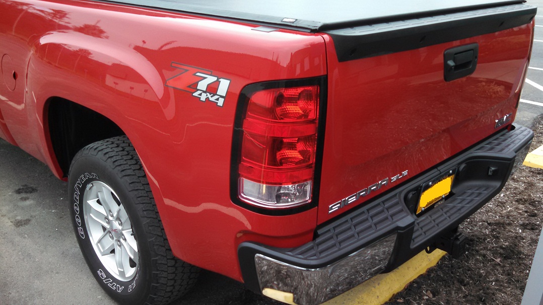

These are getting pretty reasonable now. I paid $160 a pair for mint used. They really enhance the looks of the truck. One Caveat: GMC changed the reverse bulb size in 2009, so if you are looking for them, make sure you choose the correct units for your year.
20822394 - Left '10-'13 3047 reverse bulb
20822395 - Right '10-'13 3047 reverse bulb
25958486 - Left '07-'10 2010 1st design
25958487 - Right '07-'10 2010 1st design
20840269 - Left '10-'11 2nd design 921 reverse bulb
20840270 - Right '10-11 2nd design 921 reverse bulb
It's all about the details. I was pleased with the looks. I got the idea from the new K2XX trucks, since they all have taillamps with the small black outlining.
Looks good! Is the only difference the black outline? I'm not a fan of the goofy aftermarket styles....the factory options always look best to me!
