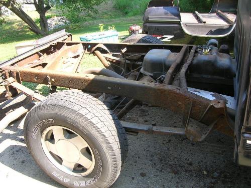

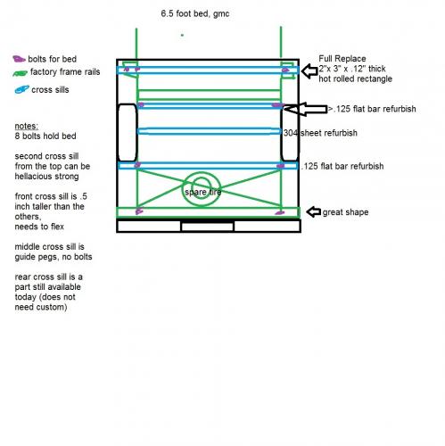

bed sills
very common chore in my locale.. if the cross sills survive after 15 years of this place, you got a broken frame near the cab. It is a good sign to find mutilated cross sills in used truck buying.
have some steel on the way, most if it on hand. Will be getting this done is a week or so.
I was lucky to find onlinemetals.com choice of rectangle. Perfect fit on order... will be shipped to me.
I learned thicker than 1/8th is headed for a frame challenge.. starts with the rivets of GMs crossmember tying the frame in the back. that front sill needs some wiggle room. Steel gets owned by thicker steel, hence no greater than 1/8th inch as choice.
the second sill back can be amonster, and will be making it one.
third one back is the most flexing, and it is the shortest. I am recovering the remains with 304 sheet steel.
The next one back is going to be an easy going flat bar job, a little weaker that the second to the front.
The cross sill rear, is a replacable part, someone did very good at replacing or just keeping factory mint.
The inspiration for this is someones many hours of body work, full panel replacements. Well worth some cross sills.
rhino bed lining is no errors as well.

cross sills installed
long weekend. About 16 hours in all...
20 feet of cross sill, approx 3 pounds of weld.
45-55 pounds added to the weight of bed.
the full rectangle front cross sill and the way cab mounts work together..wow. I made quite a combo. Very robust. Much bigger than factory.
the rear left shock mount scab, and a plate on the outside of frame in the same area...was looking forward to that one since I bought the truck. that wa salso listed in the sales agreement.. glad the guy was honest. Got right after the plan and action eventually.
very rugged feeling truck.. alot of things to notice. Still a half ton suspension, seems comical, the way all this ties together..no pun.
