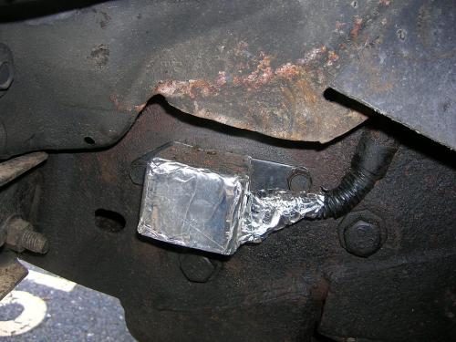

wrap front air bag sensors

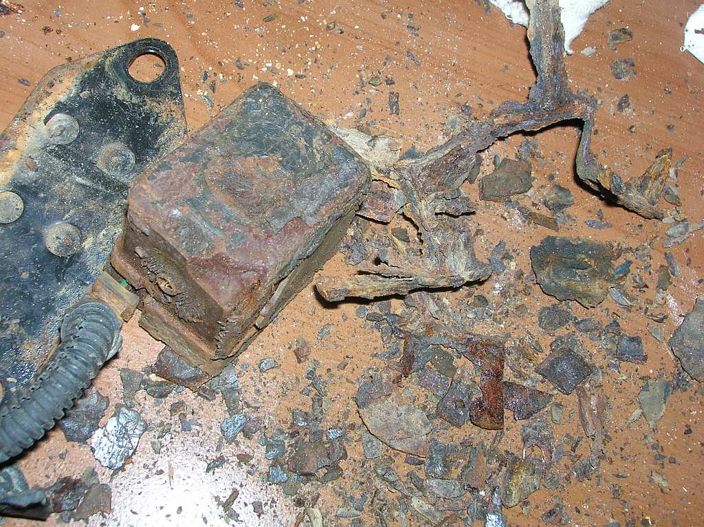

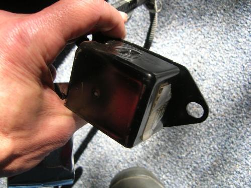

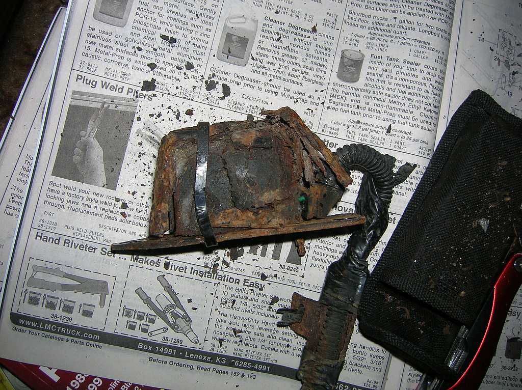

something interesting to this extra chore. I recovered the passenger side with stainless steel (304 polished) and aluminum tape. The truck ran quite crisp and defined..I was already impressed with it, but simply noticed the wrap did something.

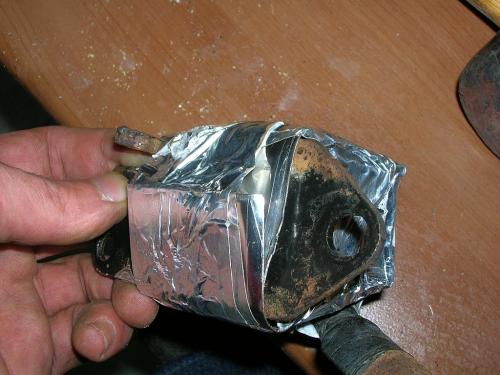

so I got both of them. Took them both off to get a full wrap, tape in a couple of layers. I am not swapping out the homemade cover one for the new one on the way... I liked it that much. Passenger side had years of rad cap above, battery, the fender well is the air intake area..stormy pig maker. Steel fell part...left the rubber sensor in good shape. Exposed proved that EMI owns these things in the weirdest ways. They both responded dramatically to EMI reduction. Living and learning..did not know those were that feisty just simply sitting there waiting for an accident.
some photos of the home made cover..for the passenger side. it was in bad decay.
the steps along the way. The stainless bent right is resilient enough to make a tightening action as a clamp as it was bolted to the truck. I have used the 4 foot by 10 foot 304 polished stainless sheet for almost 2 years now on little things like this. To buy that sheet is a pretty penny.. I use it wisely.
The tape can be found at truck stops most often.. my dad handed some to me. He has been using that for years , since the 1980s in his trucking career. Trucks are much smarter today...but that tape did a lot of work over the years.
Another more common one for EMI is something called "copper tape", the aluminum is just as good.

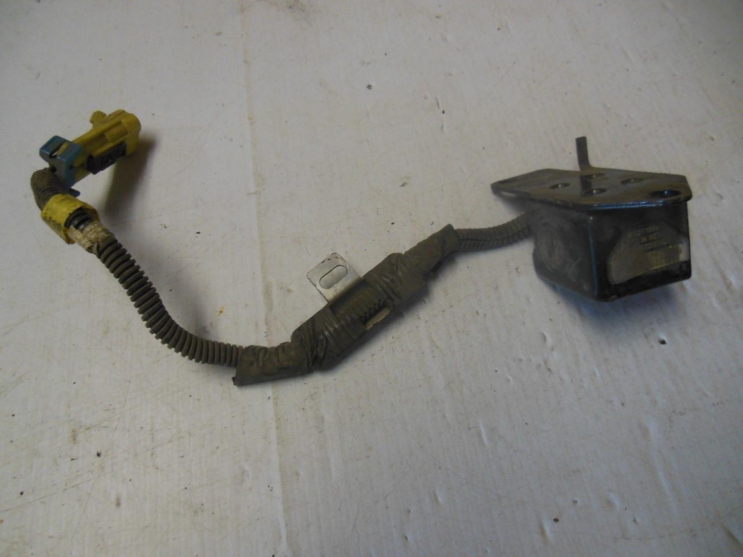

new air bag sensor
got this in the mail, very good shape. Hard to believe the truck rotted one and popped it off, seeing how rugged these things are. I wrapped up the new one with the metal EMI tape, after making it even cleaner than the photo, and put it on the truck. I also wire brushed the frame that sits behind it, like someone did for the driver side. these sensors have a function eyond my knowledge, only going with what the truck is giving. Ashame people are afraid of steel, this leaves complex gadgets in an even darker abyss.

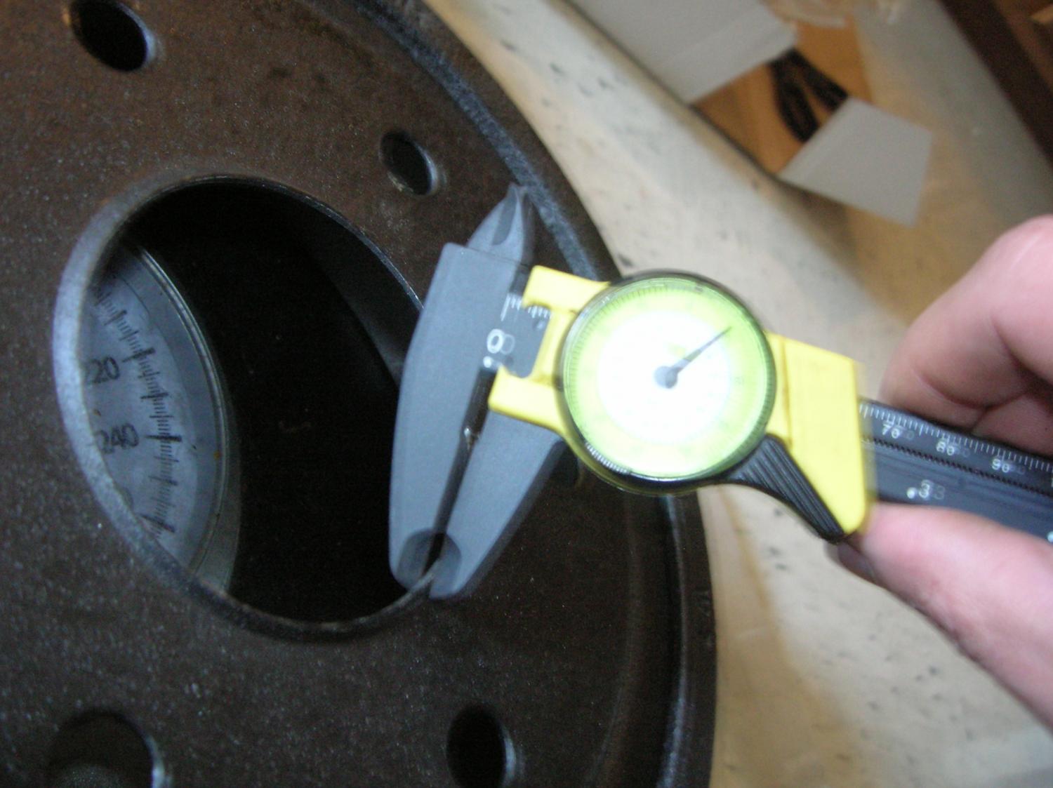

Got them both today, and compared them.
Cutting the lengthy post short:
the new bendix is 3 pounds lighter than a worn ac delco.
I had my doubts. I wanted heavy.
21 pounds turned out to b enough. the new ac delco was 24..even though the box claimed 22.
Not much to notice, a couple of pounds..when the overall vehicle is 5000.
I slapped on the bendix today, as they showed up first. there is some serious updates to any brand since 1996, I'd probably call them all good.
a concentric rib in the middle is just one thing to notice.
The old hubs was so far out of bounds, simply measured with a steel ruler, I did not need to dig at any numbers any further. Those go to recycle soon.
