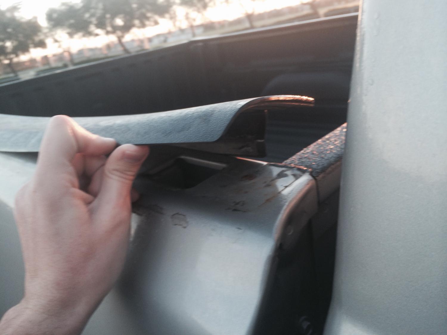

Hi guys, I've got a quick and kind of stupid question. The bed rail caps on my Sierra are peeling off, do you guys have any idea what I can put underneath them to keep them from permanently coming off and flapping in the wind while I'm driving?
Thanks

Have you tried Gorilla Glue? That stuff is suppose to be really good.
I can't believe I hadn't thought of that one, thanks I'll try that and hopefully it will work.
3M foam backed tape (the same material GM uses to attach badges and door moldings) is available at most any auto parts store and would be equially effective (and less permenant). Id go with that.
The main thing is that it needs to stick, I would of had it sprayed like the bed but there was some issue with one of the rails , so It would be fine if it was permanent from now on. But would tape keep it down in high wind scenarios? (I take my truck to the dunes and occasionally we have gale force winds when we stay there)
