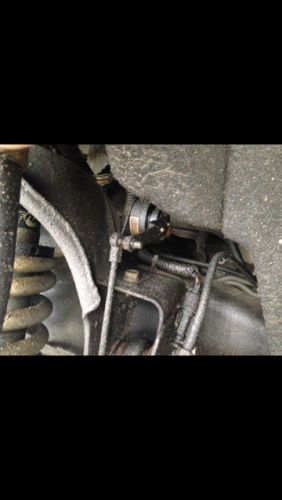

Ok everyone, I have fixed the problem on my truck and still have the RC 2.5" front leveling kit on. here are a couple pictures. Basically, when you level your truck, you are pulling the arm of the MagnaRide sensors down. This is making the suspension think you are about to bottom out so it stiffens up. To fix this, the arm of the sensor needs to moved back into what I call the "home" or level position. I fixed this with the small bracket shown and a couple nuts and bolts. I also powder coated it black to look factory. Sorry for the crappy pics but you should at least have a good idea now. Hope this helps.

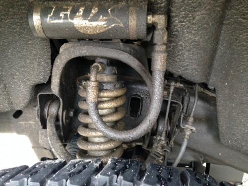

Does anyone know if the control arms for the magna ride still have any effect if I've changed my whole suspension and shocks to the bds with full coil overs, fox shocks with reservoir? Mine are obviously not leveled properly anymore since the lift but the magnetic ride is disconnected now obviously since I run different shocks. Do these control arms and sensors, and magnetic use being disconnected affect anything else other then having the service suspension on screen when I boot up the truck? the truck bogs down as if it's cutting out the power when taking tighter turns and such like if the stablitrak is going off due to sensors thinking i am off balance or sideways. Any thoughts anyone?
To my question above here's some pictures of my setup and how the control arms to the suspension are no longer leveled after the lift.
