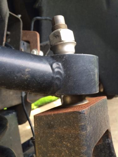

Mike1220 Posted November 11, 2016 Posted November 11, 2016 okay, so looks like this would be a good thread to throw this question on, when I received my Cognito UCAs, I was reading the instructions and they show that the ball joint needs to be installed from the top, however the instructions showed a different control arm (ours are boxed, instructions showed rounded) and so I turned to look at the internet when I was installing mine and every website (including Cognito) had them installed from below. So I installed mine from below. I attempted to call Cognito twice but both times I sat listening to music for 15-20 minutes before ending the call. Calls were made on different days and both times I talked to the operator and she directed my call respectively Curious to see if anyone else has had this same situation where instructions said one way but looks like everyone else says another way. I had stock Aluminum UCAs
