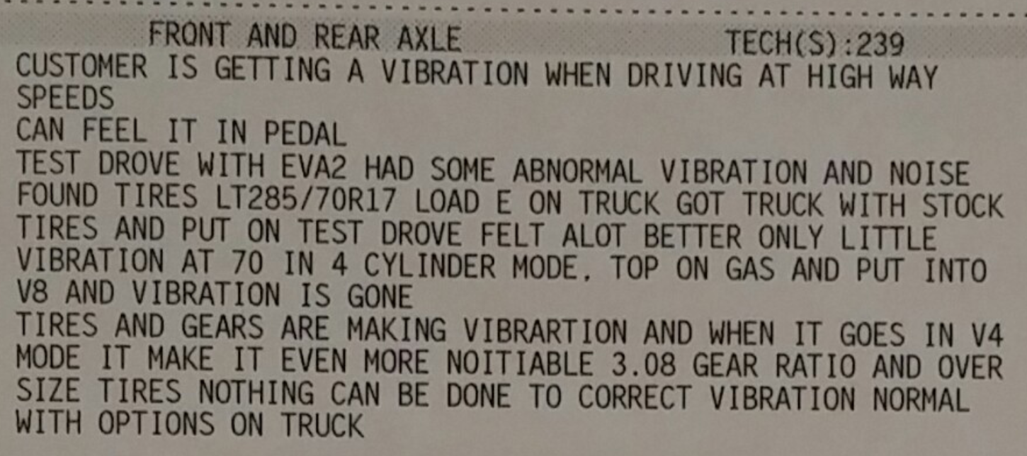

So although I've felt my truck runs fine with 3.08's and larger tires this might be good reason or proof it may not be the best idea. See my attached image on what my dealership said regarding a slight vibrations I was feeling. And to add to this these same larger tires I had swapped onto the 2014 I did not have the issue in my 2005 with 3.42's.
There's your problem! You haven't disabled AFM yet. I don't know how people can stand V4 with a bone stock truck let-alone a modded one lol.
I never really noticed much of a difference when in v8 vs v4 but never really paid too close attention either. I've been wanting to do some mpg comparisons anyway between 87 and E85 so might as well add AFM on and off in the mix too. Sounds like most everyone prefers AFM off might as well join the crowd.
