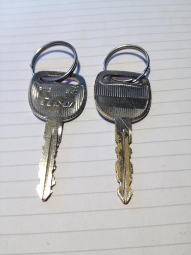

Zimtok Posted June 8, 2015 Posted June 8, 2015 I received 3 keys from the previous owner of my 04 Yukon XL. Two are cut the same, the other one is cut differently on one side. The odd key only works if you put it in "the right way". What is this odd cut key for? .

Zimtok Posted June 8, 2015 Author Posted June 8, 2015 It is unknown if the keys are original GM. Can you tell by the attached photo? It will start the vehicle and allow everything to work. .
Zimtok Posted June 9, 2015 Author Posted June 9, 2015 The key was cut to work on two different vehicles. . I would never have thought of that.... I don't think the previous owner would have known that or had it done. .
