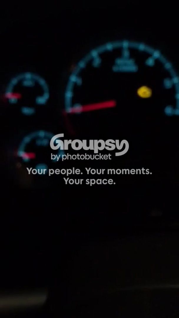

Edit: I'm going to start with the start fluid since that doesn't take long and is easy to do. Also, I attached a video of what the truck does. It's blurry for some reason but you can clearly see the needle drop. It doesn't look like much but you can definitely feel it sitting in the truck.
http://vid44.photobucket.com/albums/f38/Cheezeit9/IMG_1715.mp4
