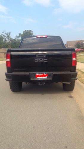

I ended up having the bumpers professional wrapped. Just thought I would show everyone how they turned out.
