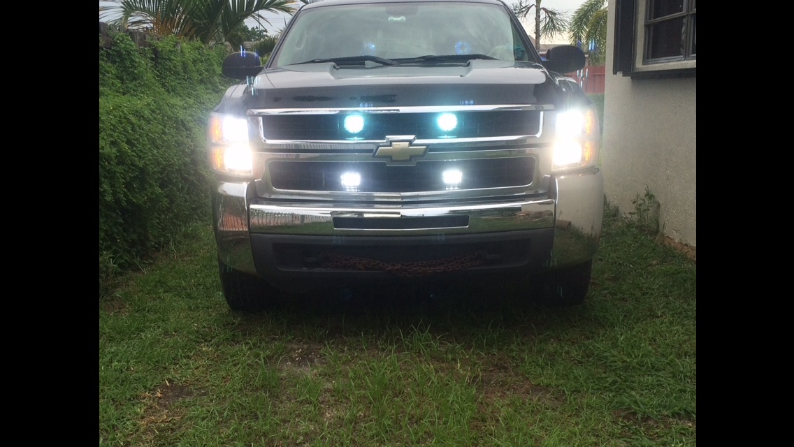

I just installed on my NBS 07 2500 a set of 3.5" 55w HID spots and a set 4" LED floods in the front along with the 40w LED headlights and 100w super white halogen high beams extreme bright day or night
Here's a pic at about high noon
40w LED H11 headlights
100w halogen high-beams
55w HID spots top center
20w 4" LED floods center bottom
Soon there will also be a 20" dual bar in the bumper air dam
