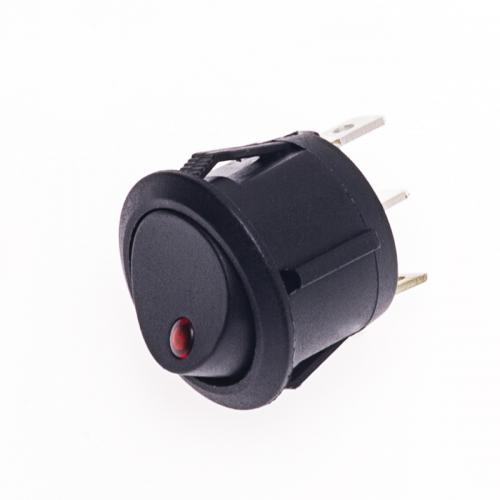

If you dont use all your 12v / cigarette lighters, I took one out and placed a round toggle switch in place of the socket. Works perfect and looks stock. The cover even works as the switch is small. So closing the cover is not a problem.
Here is the toggle I used for my light bar.

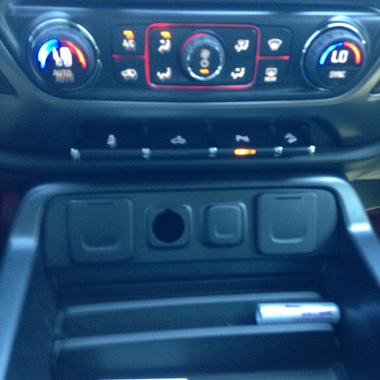

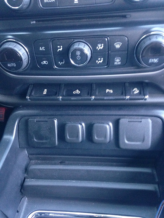

I took out the cigarette socket exposing the empty hole. Without any modifications, a LED round toggle switch fits perfect in the hole.
Here is some pics to show you. First pic with it removed, second pic shows the toggle and third shows how the cover closes still even with the switch installed giving it a stock look.
That switch install is awesome. I am impressed.
