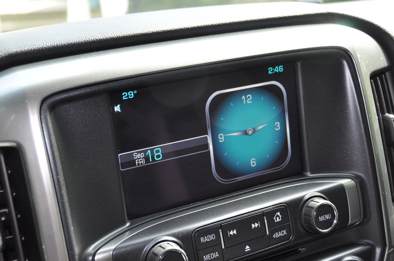

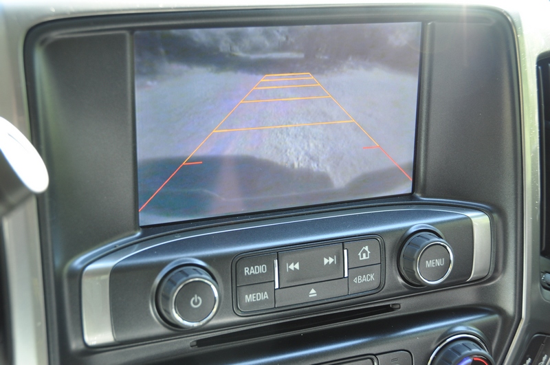

Here is what the back-up camera view looks like compared to the normal screen. If anyone thinks this is good enough then you have very low expectations of today's technology.
I have a 15 Denali, 4x4, 5.3L. And my camera looks NOTHING like that when I put it into reverse...

I agree with the guy above me. I have a 2014 Silverado and my camera looks nothing like that. I can't tell if it's glare, or maybe the actual camera lens on tailgate is dirty or scratched......? But mine is a lot clearer than that. Is it possible that moisture got behind the camera lens?

Jaybridge88 has a very good point. I went backed and looked at your pic. It's possible it could be built up condensation... See that purple haze look... Worth a shot

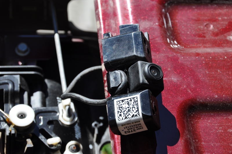

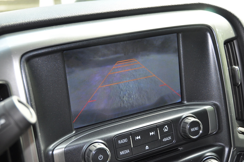

Good suggestions, guys. So, today I pulled the camera out to have a close look at it, but could find nothing wrong. The camera head itself is a sealed unit with no sign of moisture inside and the plastic cover over the lens is not marked up. I did disconnect the wiring connector and reset it, but to no avail. Thanks for the ideas anyways. For those interested, it only took about 15 minutes to get it out and that included removing the tailgate liner. Two screws hold the plastic camera mount in place, then two screws hold the wiring connector to the back of the lens module and two screws hold the lens module to the plastic mount.
The camera in the plastic mount-
The view after re-assembly-
Something is wrong with your camera. That's what mine looks like with rain and dirt on it. Have it replaced under warranty. Have them compare it to a new one on the lot if they give you any flack.
