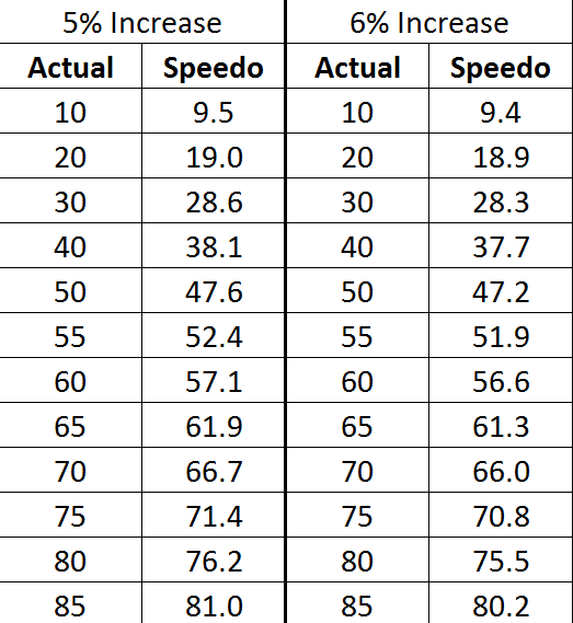

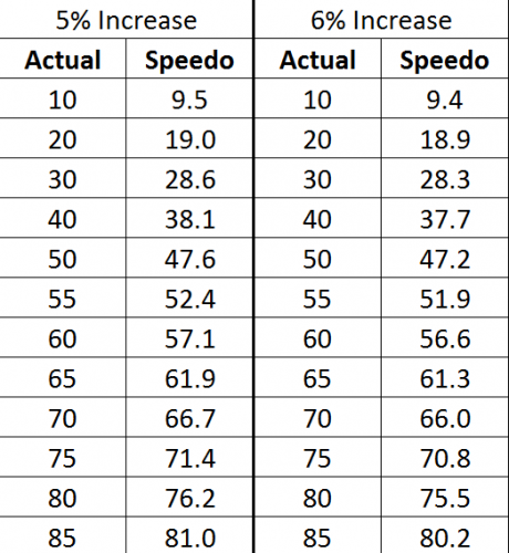

Its not bad. remember that you'll be ~5.0% - 6.0% off on your speedo, fuel mileage, and odometer. Basically, multiply your displayed mpg by 1.05 to get the true number; and you'll get 5.0% free miles on your odometer since the truck doesn't know the difference between the tires.
As far as the speedo; tyou should fall somewhere between these two charts
