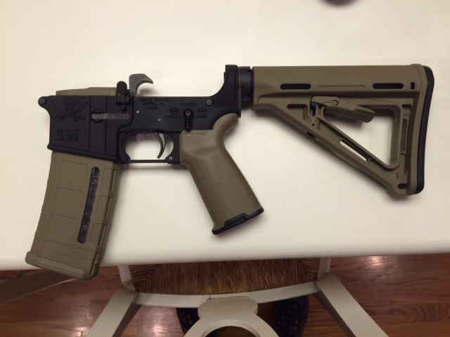

Got the lower put together. Now just deciding on what upper I want (and waiting for places to get them back in stock).
Good job, I usually scratch all mine trying to get the pin in the bolt catch.
Thanks, guys. It's my first build so I was extra careful. ha ha.
One thing I wish I had done was got the painted lower. I thought about doing the crayon trick to fill in the lettering but wasn't sure if it would look right on the Jolly Roger logo. I did white on my Glock and it turned out well though. If I do it I might try to find a tan crayon and keep the whole tan/black theme going. White might contrast too much.

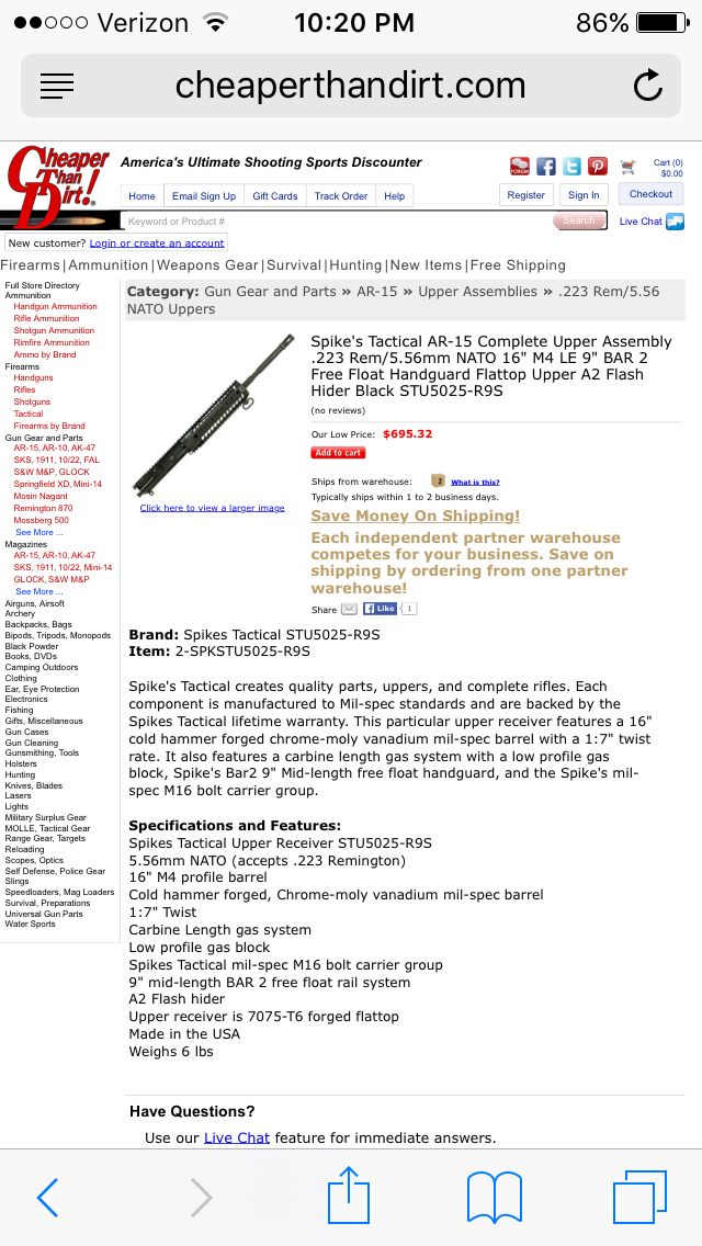

I'm still hunting for one since everywhere online is out of stock but I did find this one still in stock on CheaperThanDirt.com.
http://www.cheaperthandirt.com/product/... rce=search
First off is this a good lower? Second. I'm not sure if I will like the 9" hand guard. I was thinking about wanting an 11" or so. How easy would it be to replace the 9" with a longer one if I wanted to? Since it's a free-float hand guard does that make it easier to replace with a longer free float hand guard? Do I have to mess with the gas block, etc?
That Spikes lower is a good starting point.
I would not buy anything from CTD, they are a terrible company and do not support gun owners. Don't forget these are the same people who pulled items off the shelf and attempted to sell AR & pistol mags. for $100 and more during the last panic!
For the rest of your build, check out Bravo Company USA, they will have everything you need to build a good quality AR. They don't sell garbage like many others, nothing but quality parts using the correct materials and tested properly as well.
Another good place for parts is Primary Arms. They have a huge selection and good prices BUT do sell some lower quality, cheaply made parts. They also sell top quality FN uppers made to military standards they use while building the M4 & M16 for the govt. Going that route, you know for sure your gas port will be the correct size and don't have to worry about being overgassed or under-gassed like many others. Primary Arms is pretty much a one stop shop for a good build, you just need to know what to look for in good, correct part.
Did your Spikes upper come with a buffer spring and buffer weight? If so, what weight did you receive? Make sure you have the best weight buffer for your ga system length.
Looks like you also received the Spikes "battle trigger". Good deal, it's definitely improved over the standard GI trigger for sure.
If you are dead set on one of the uppers you listed, I would go CMMG over Adams every time. They are usually hit or miss with their stuff but better quality and use better materials than Adams. Their Bolt carrier groups are a little iffy though, sometimes the gas key staking is not correct but you can actually fix that on your own with a punch. They also test their barrels and bolt steel properly.
If it were my carbine, I would either order a complete BCM upper. It will be built and tested properly and ready to go out of the box. It should not matter what type of handguard any upper comes with so don't base your decision on that. You can purchase and install any handguard you wish.
OR.......
purchase a complete Colt M4 (6920) upper from G&R Tactical. G&R is a great little company and offer just about anything you could want. Grant has excellent customer service, sells quality parts, and his prices are hard to beat as well. A complete Colt 6920 (M4) upper for under $630, hard to beat! Can't go wrong with a Colt, they do it right and have been building AR's since the beginning. They also carry complete Daniel Defense and BCM uppers.
All much better quality than the two you had listed.
You already got yourself a good lower, don't cheap out when it comes to the upper. Quality goes a long way for a reliable rifle you can depend on. Go with the proven, well known and respected in the industry company (Colt, Daniel Defense, FN, BCM), you'll be glad you did.

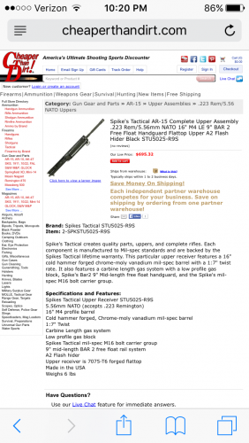

Not sure why but the link didn't work. Here is the upper from Spikes.
Is this a good upper? I figured it would work with the lower and all the other spikes stuff I got.
