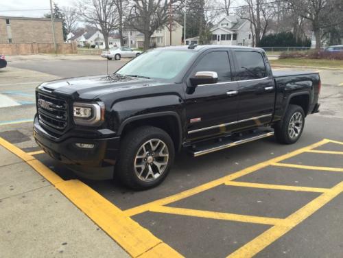

Just picked up a new '16 Sierra AT. I live in Michigan where winters can be a little brutal, and salt becomes a normal part of life. Before this truck I had an 04 Denali that I didn't really give a shit about, so never really took the time to research what should be done to keep the truck in good condition.
Now I have a brand new truck that I'm hell bent on keeping looking brand new. I just dropped it off today for a clear bra. Will have Opticoat applied when the Spring rolls around.
I spoke with the detailer regarding the underbody, and they mentioned they do a coating (forget the brand) that cost $675. They recommended doing it before the truck sees any salt...They also said some people do an oil coating in the door jams and underbody. That just sounds messy to me.
Wondering what tips and suggestions you guys have for avoiding rust and keeping the truck looking new.
Thanks all! Pics for clicks!
