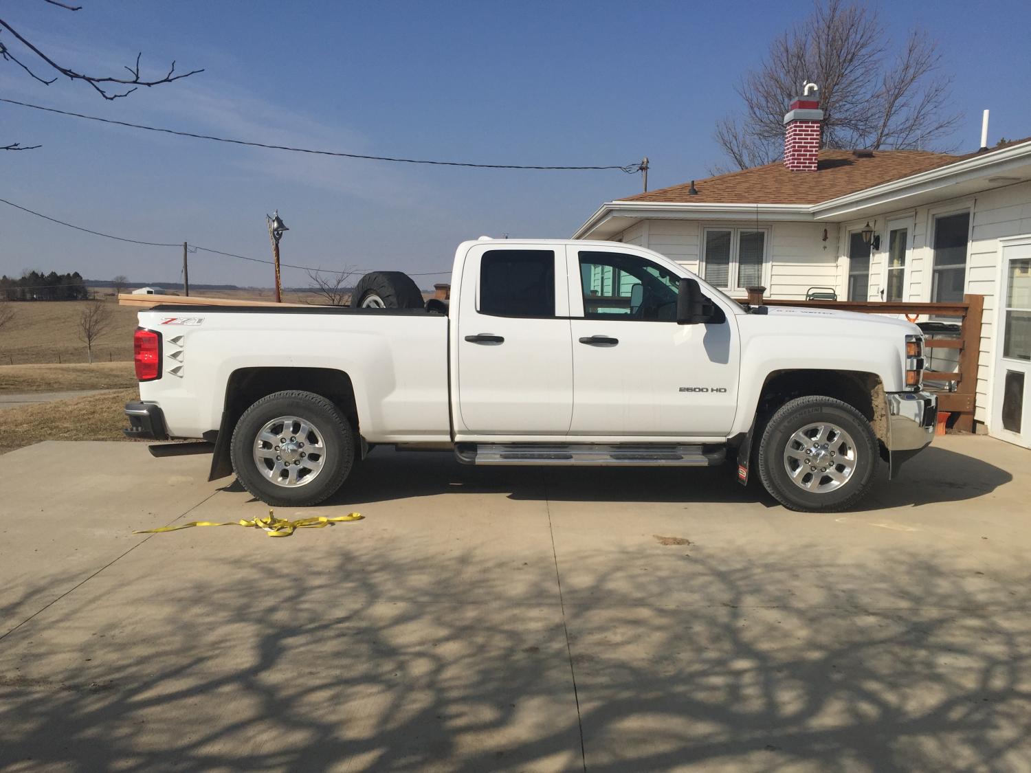

Had a load in the back of the pickup today. Just shy of a ton of stuff total. The pic of the pickup with 2" lowered McGaughy's a couple of posts back, and these show rake on pickup with almost a ton of stuff in the back even with the McGaughy's 2" lowered shackles on. No air bags for support.
As a side note.... the tires have my normal 55 PSI in them instead of the 60/70 OEM recommended pressures. I suppose going up to 60 at least in the back might have been a good idea, but the drive home with the stuff was only about 50 miles.

What do you have going on by your tail lights, on the bed side there Cowpie?
Those are air tabs. They are used by commercial trucks to improve aerodynamic air flow across and behind trucks. I have them on my semi. I had a bunch left over and so I stuck them across top on the back of the cab and on the sides as you see. Was curious if they helped any. Can't say that they have done a lot for mpg, but since I put them on, I get a lot less dust build up in the box and on the back running up and down our gravel roads. So it must be helping a little. Was cheap. They are just peel and stick. I painted them the color of my semi truck for that application. They come in white or black and I had white. So just stuck 'em on.
