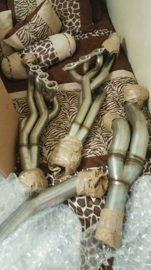

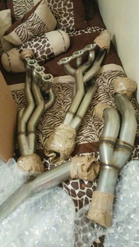

I have 1 7/8" ARH catless ORYs waiting for me at home..... Cant wait to get them installed!!!
