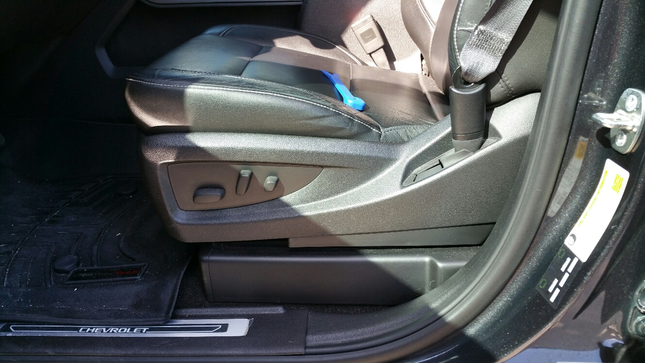

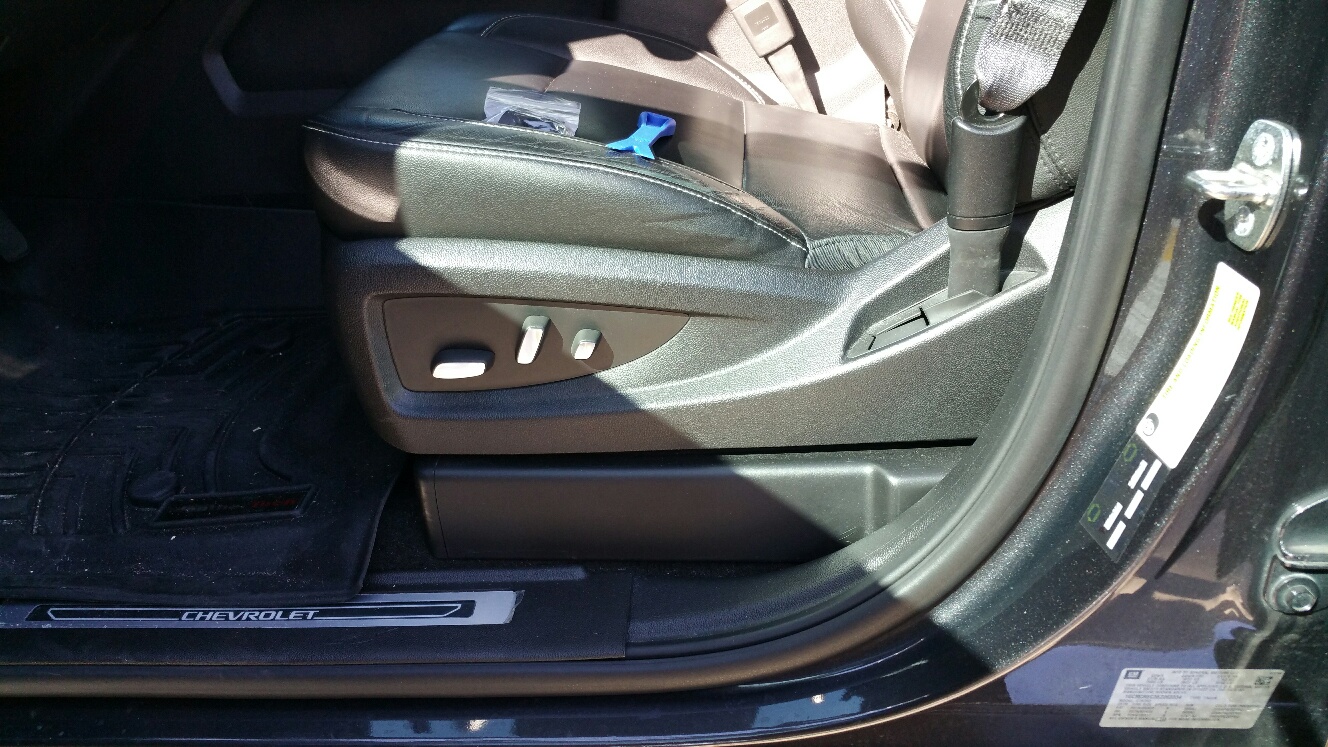

All of the buttons are changeable on the switches. Go for it. They look identical in design to the regular ones, so they should just snap right on.
It looks like he has highlighted the wrong item. The part number above is for the panel behind the knobs.
It looks like the knobs you need are: 22898995, 22898997 & 22898999. Looking at your picture there is a chrome piece on the backing panel as well above the switches. If you want that the part number looks to be 22991022. It's a bit pricey for the panel. The knobs are fairly cheap. Oh and by the way, this fits the EXT model of the Escalade.
i got him close right? the panel has the metal on it as well. from that page you can get to the knobs. just trying to help.
There is like 3 different set-ups along with different knobs with each set-up. I thought the knobs were all the same too but they are not. The panel number you provided got me to the right area. You have to scroll to the bottom set of numbers to get the right ones. The panel you provided must not have the chrome piece on it as it was much cheaper than the panel with it. Heck, I ordered all the parts today for myself....

I just got my parts in today. The seat panel behind the switches is definitely a worth while add on as well. It comes with the chrome trim as well as a gloss back ground plate as well.
Knobs pop off pretty easy. Be careful installing them as they are keyed to a certain position. Jut look at the backs before you install them, they will only go on easy one way. Knobs were about $13.00 each, the panel is about $85.00. I just need to figure out how the seat belt goes thru the panel before I install it. It's held on by 2 screws and then pulls off.
