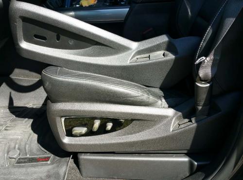

I just got my parts in today. The seat panel behind the switches is definitely a worth while add on as well. It comes with the chrome trim as well as a gloss back ground plate as well.

Well I just finished up with the panel. What a bear! It is not as easy as you think. The seat belt has to be disconnected to go thru the panel, there are 2 screws holding the panel on as well as some clips that hold it tight. You have to switch out the switch assembly for the three switches and then reassemble everything. It is worth it though, looks sweet.
Sorry it took a while. I actually had to redo it as one of my switches went bad. It was notchy so I decided to change it. Here you go, sorry for the dirty truck:
