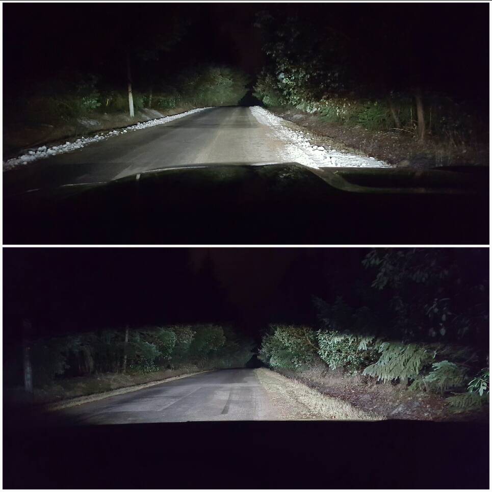

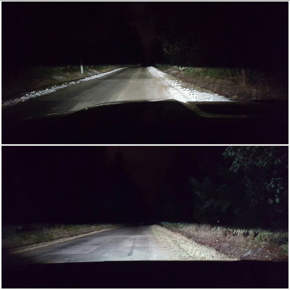

Just did this install as well. Lots of good info on this site for tips etc.
One thing for my install was I got a terrible loud buzzing from the relays causing one light to flicker bad. I ended up reversing the plug for the capacitor link..seemed odd as it doesn't have a little catch for the clip on the other side but it works like a charm now.
I had the xenon depot LEDS and these are so much better! I don't have a before and after...doh... but I did do a comparison with my 2017 Santa Fe XL ultimate. They are supposed to be one of the better ones out there, doing very well on the new IIHS headlights test (which the Sierra failed miserably)
First pic is high beams and second is low. Top half of each is the Sierra, Bottom the Santa Fe
