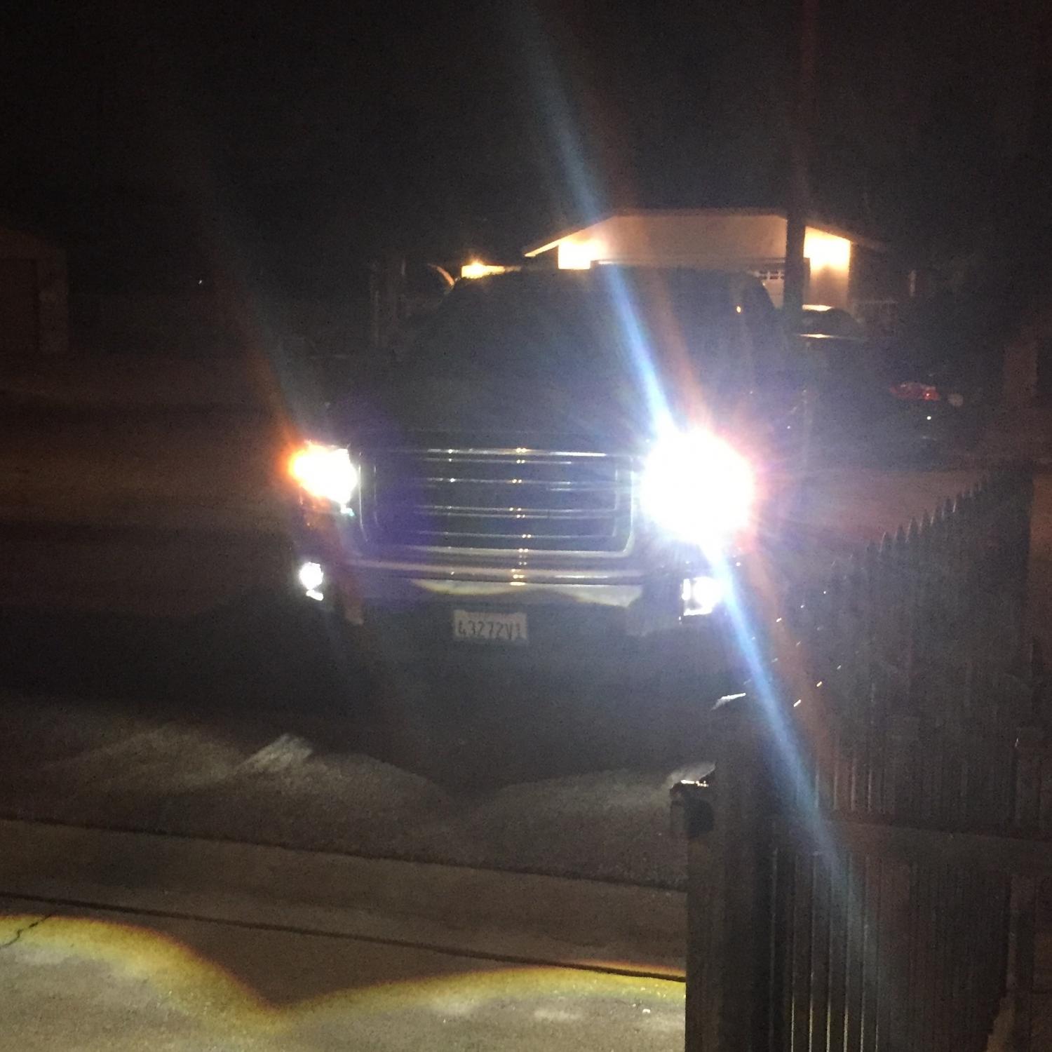

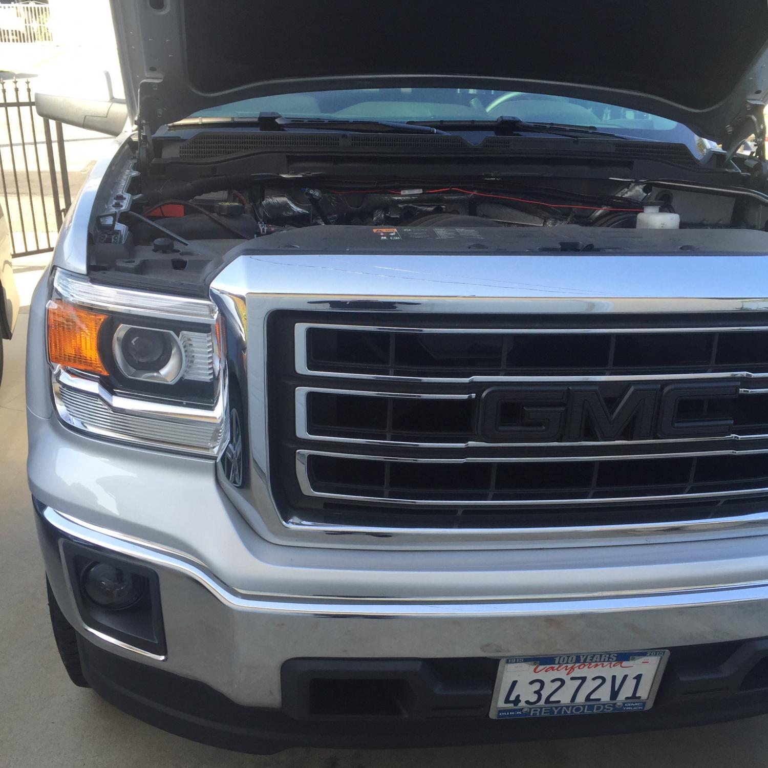

Did the HID install today, went with The Sierra Spec kit in 35w 5500k from TRS.

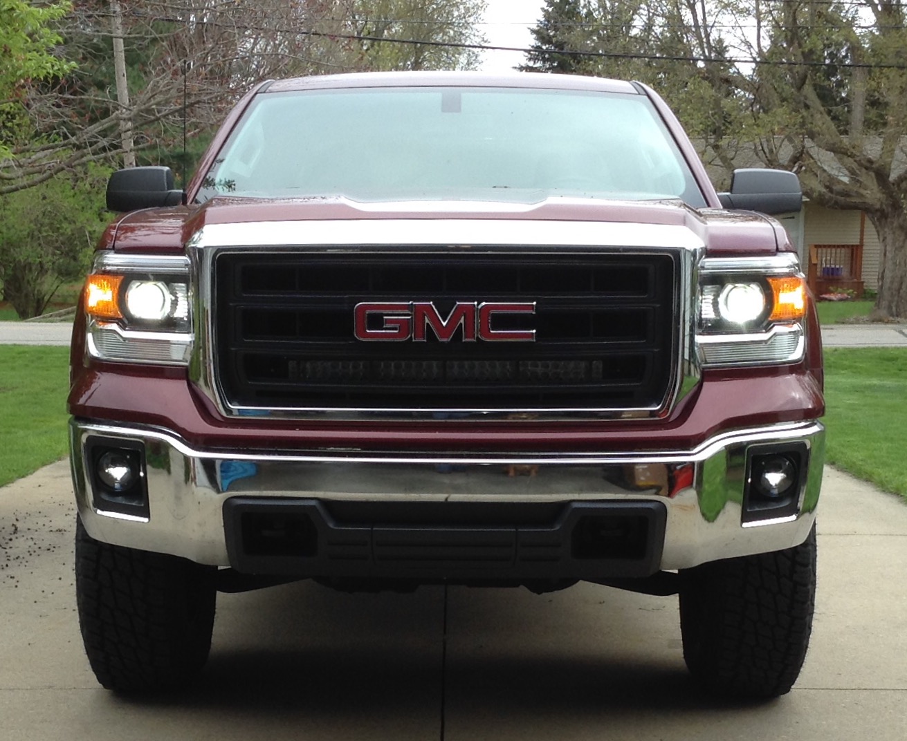

Installed mine today as well, 5500k 35w Kit with the fog lights.
So, how do you like it? Pics of the lights shining on the road, rather than on the truck would be great. Any issues?
