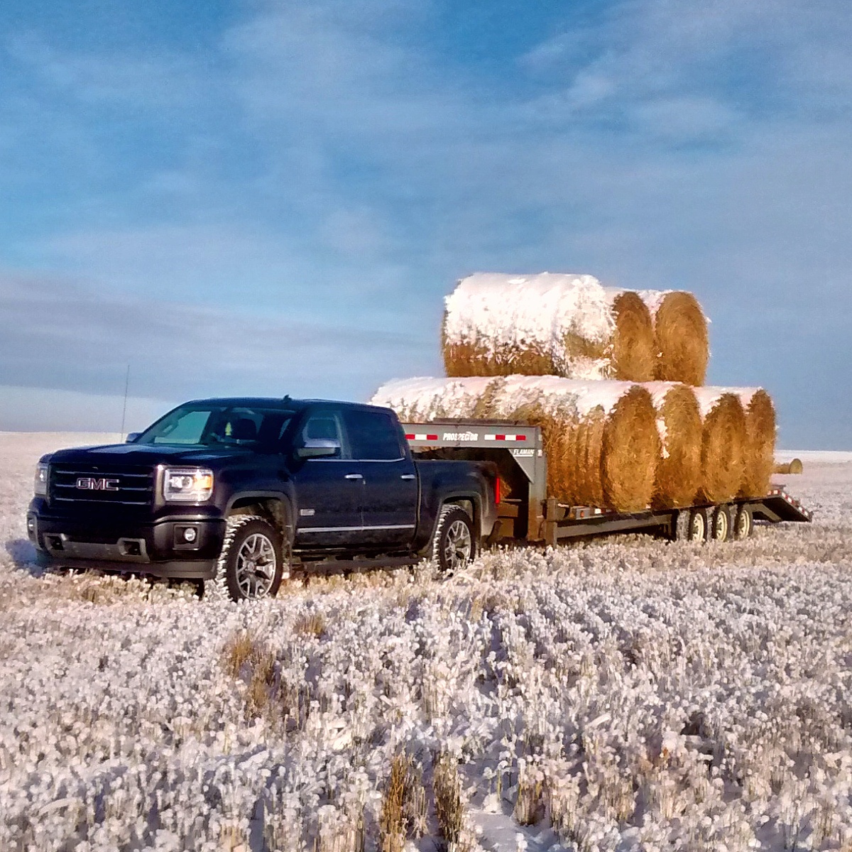

Lol I know right, it really pulls really well, I don't try to be super man tho, I'm happy at 62/64, last fall I took a trip down the Thruway and was able to set the cruise @64 and relax and enjoy the ride, sure I uped it to 68/70 just to c, it was also fine there just worked harder obviously,
BTW the second pic with hay bails is awesome!!!
