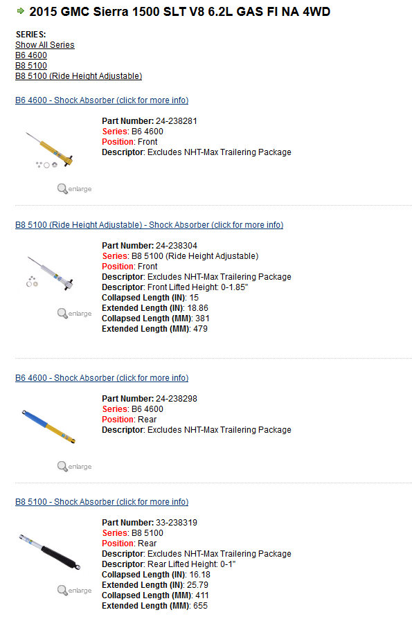

Is anyone aware of a replacement shock that is recommended by the manufacturer to be used with the NHT option (Max Trailering option). As an example, if you search Bilstein's site, they specifically exclude it.
I have 2018 NHT max tow 4x4.
I installed bilstein 5100 front and rear. Handles like a truck now, not bouncy anymore and much firmer ride which I like.
Front 24-238304
Rear 33-238319
I raised my front 1.75” (3rd notch from bottom)
if if you are not going to raise the front then go 4600.
Front 24-238304
Rear 33-238319

 Most I have towed is 3500lb enclosed 7x14 trailer. Tongue weight was 300 - 350lb according to my weigh safe hitch. Truck handled it no problem. The stock shocks were way to bouncy. The Bilstein 5100's definitely firmed everything up.
