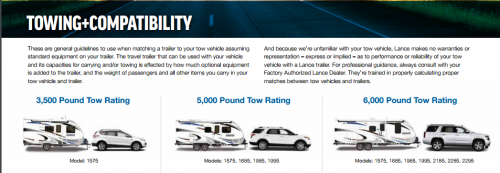

As an example, Lance makes a line of light weight trailers.
http://www.lancecamper.com/travel-trailers/z
Thanks for the suggestion. I enjoyed the video on how these are constructed! No debate over wood or aluminum framing as they are virtually frameless!

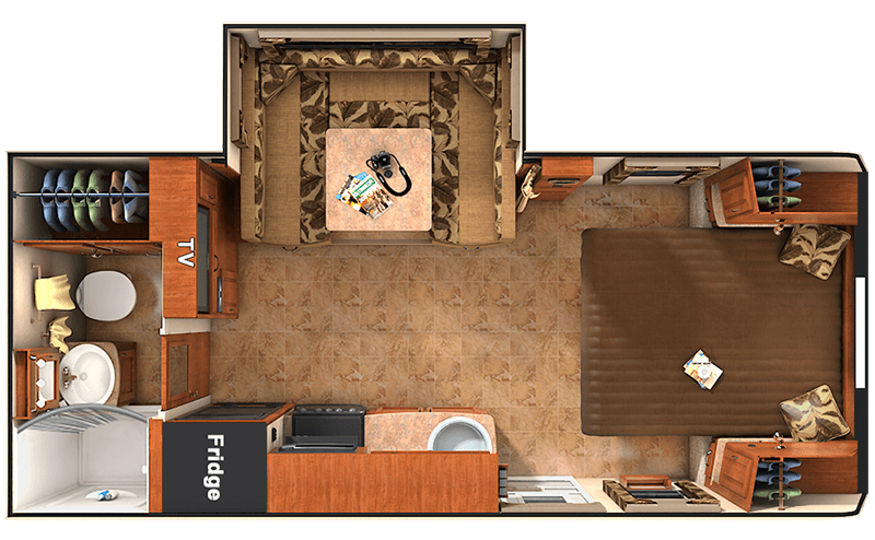

This trailer looks great! Thank you! It has a dry weight of 3925 lbs. I imagine this would be an easy tow for a six cylinder Sierra. I know there are ultra light trailers that can be pulled by small cars to huge fifth wheels that require a V8 1 ton. I am trying to establish a "real world" limit for my new truck. I remember what it is like driving through hilly terrain with the gas pedal pushed to the floor on the uphill climbs hoping that you make it to the top! Going downhill can also have some stresses. I suspect that the advertised tow rating of my truck is safe and doable but I like my decision to be based on real life experiences.
