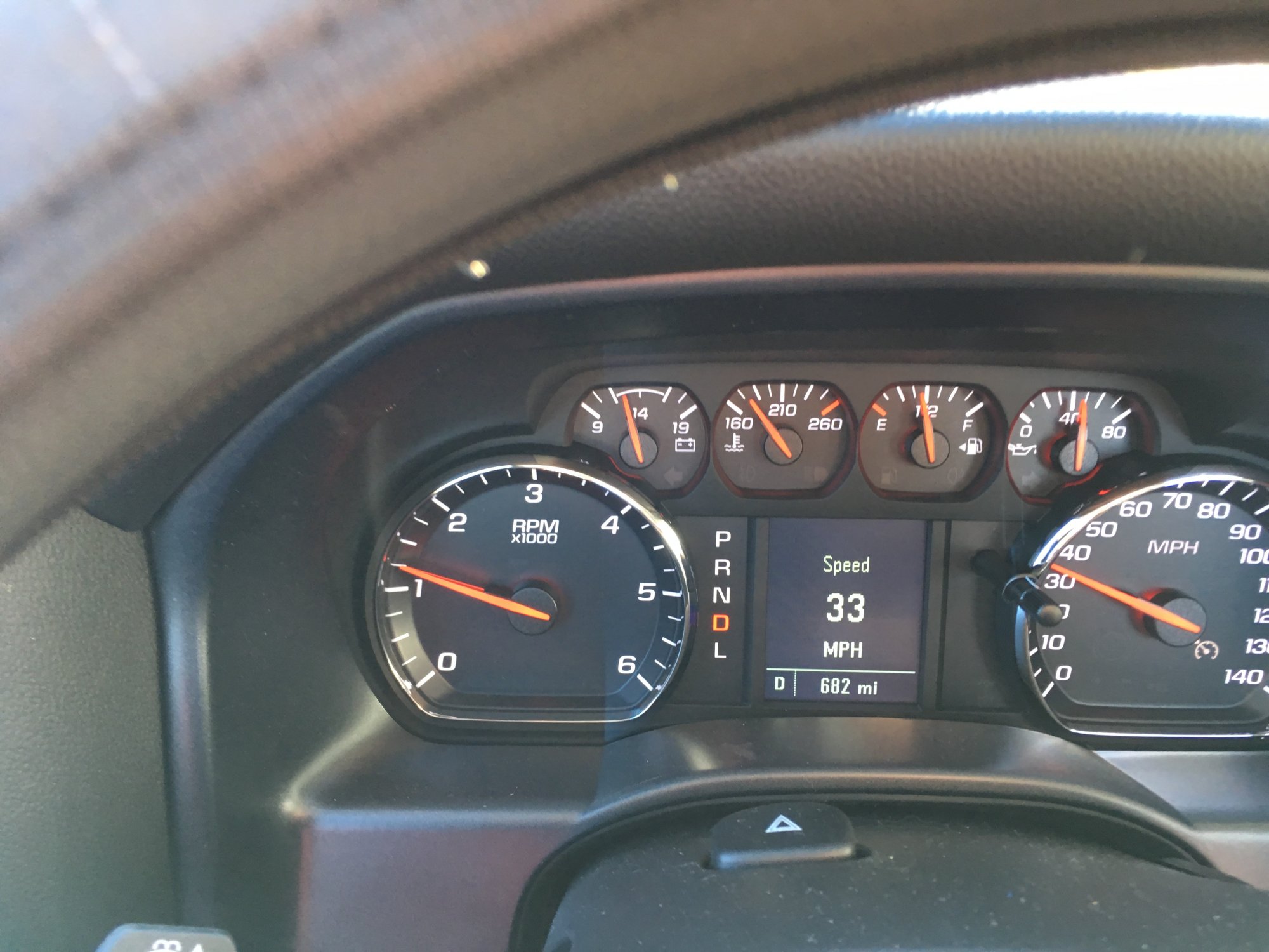

Hey everyone, my first post and a little confused by my 2015 Silverado charging system. I know it has the EPM system but after driving for a few hours I noticed the voltmeter was just inside the left normal line about 12 or so volts. No messages or chimes but didn't seem to be charging. After stopping for gas and restarting the volt meter shot up to a little above 14 volts for about 1 - 2 minutes and slowly returned to the left most normal line. After returning home the volt meter still showed what seems to be low voltage so I checked with a multi meter and got 12.8 volts. shut the engine and checked again and still 12.8 so NO charge at all while running. After restart volts always go up to 14.2, so is this normal operation for this vehicle? I have other fairly new vehicles and none do this. Thanks and I'm sorry if this has been posted before but don't want to make a trip to the dealer if this is normal!
