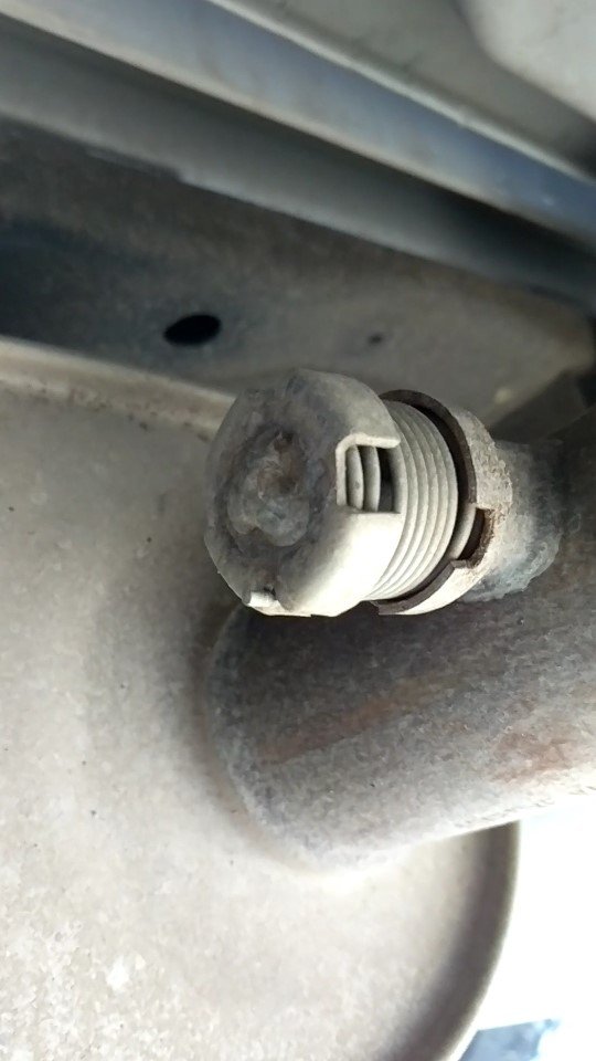

Hello ! I know this post is almost 9 months old, still I'm giving a shot.
I've  been experiencing quite the same issue with the flapper valve on my 17' Sierra 1500 for about few months now. When idling (from cold start), it make a rattling sound (which basically is the spring that rattles between the plates). By rotating it open (or close), it stops right away (see video : https://drive.google.com/file/d/1hnIOqZiJW_2hH9cbu5P9FsG36N74UVz9/view?usp=drivesdk  )
As you can see, the design (plates on each side of the spring) has slightly changed over the years (now more of a rounded shape, not square anymore), but it hasn't keep it from doing that annoying sound lol...
Dealership says they can't do anything about it (of course they don't want to replace the whole exhaust)... and I don't really want to do a full muffler delete or changing the whole exhaust system. So after reading this thread, I thought I would clamp the valve open (and call it a day). Only question I got : I know I need to do a 1/4 turn first to open it, but do I turn it clockwise or counter ?
Thanks !
Find another dealer.  You have a valid complaint under warranty.  There is an existing PIT telling them to replace the cold side of the exhaust.  If they don't want to do it they are just giving you the runaround.
I had the one on my wife's 17 cut out and a piece of pipe put in it's place. Don't have to worry about it anymore plus it gave the exhaust a little better tone.
Mine started squeaking awhile ago, but I'm out of warranty. What I noticed is if I run E85 it doesn't go into v4 mode often and therefore no squeak :).
