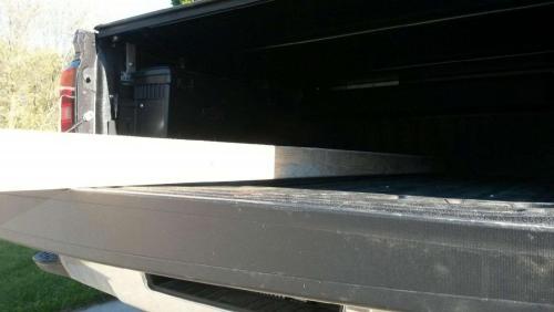

This has been eating me up and I can't figure out if its a design flaw, or if my tailgate cables are just too short. Does anyone else have this problem, or am I the only one? Note- I am not talking about having one cable shorter than the other as I have seen in an older thread.
My problem is: When the tailgate is fully open, it is higher than the bed. I put a straight 2x4 in there and measured a full inch of gap beneath it at the rear edge of the bed. I can't believe this is intentional. if I put long lumber in my truck, the tailgate is holding up all the weight, instead of having it distributed along the bottom of the bed like my old truck.

Phone was dead and charging in the house, but I can confirm that my '16 1500 is the same way. Found it odd from the time I looked at the truck on the lot so the sales guy and I checked a couple other trucks, including GMCs, and they're all the same.

There is no way that adding weight will ever push it down to "level". The cables would need to stretch over an inch to do that.

While I agree that steel cables do stretch a little under tension, they are not going to stretch 1" under any load that I can safely carry in my half-ton truck.
I have done some googling and found that my stock cables are 16.6" from center of bolt on each end. I have also found that the cables for a 94-04 S10's are 17-1/4" long, which would be the perfect length, but the ends are different. I have no idea if it would fit on my truck until I can get my hands on one. I also can't tell if the S10 cables are thinner/ weaker or made of the same size cable. Does anyone have any experience with the S10 cables?
It's not a design flaw.. It's there for safety and so that it doesn't touch the bumper. Why would you want to make the tailgate level with the bed? The tailgate is built to hold heavy weight.
