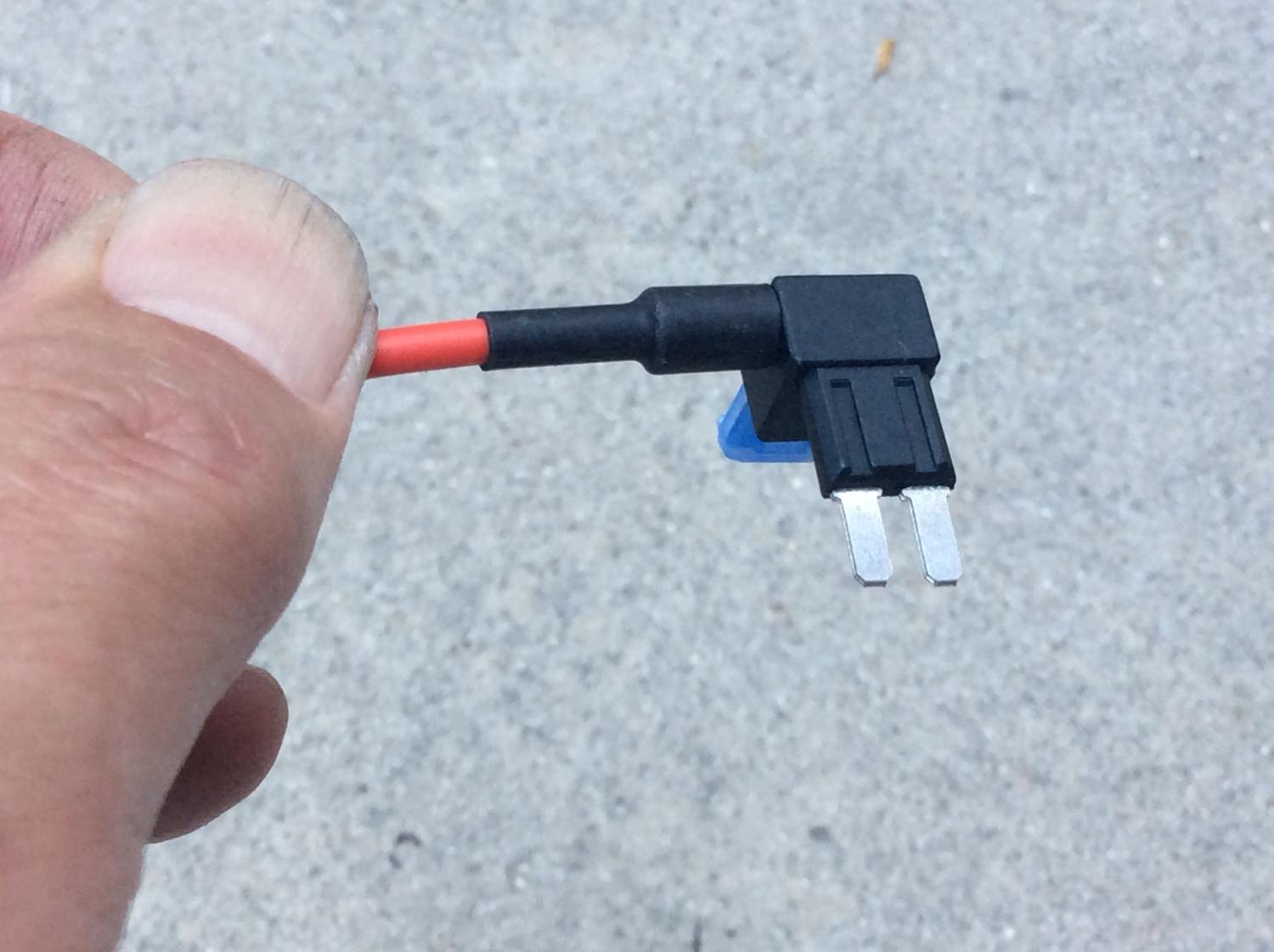

I have my truck apart this evening and I'm about to install the LED headlights and Gen5diy harness.
The Gen5diy harness has a power tap. Anyone know where/what circuit exactly they intend this tap to go?

If i recall, It taps in the X50A Fuse Block, for power.
I figured it went to the X50 panel, just not sure what circuit.
Can't comment on which circuit, though they had install instructions on the site where you buy the harness I think.
This is in their install manual.

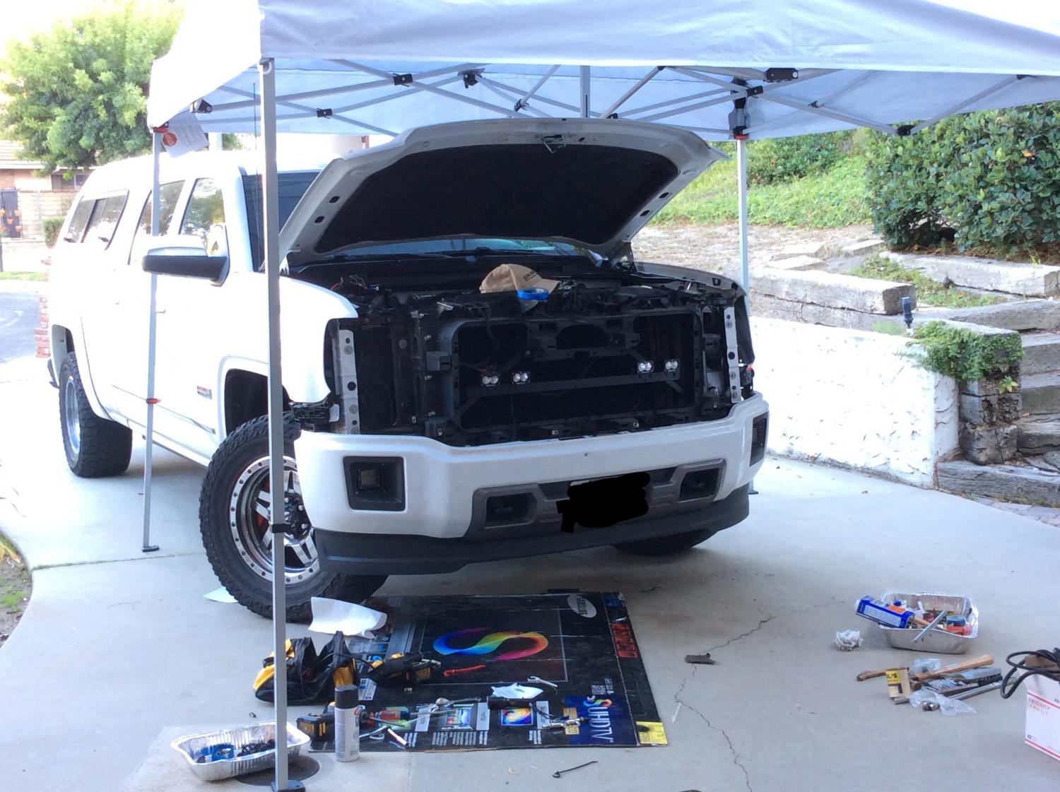

I finished the installation and I've put most of the trim back together. I checked function again and found that the headlights wouldn't come on unless the ignition was turned on. I'm at a loss where to start diagnosing this. They were working without the ignition on earlier.

I almost feel as if this is normal operation thanks to their harness.
They use a relay setup I think so it would make sense the headlights would only come on with the ignition on.
Rather than use capacitors to make up for the pulse width management they used relays.
