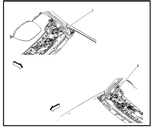

Can anyone point me to where G218 is at? I cant find a darn thing under the dash!! Please help.... I need the truck to work.... Thats why i bought a new truck :(

attachicon.gifg218.gifhere is a pic
Thanks.... Couldn't get very much done but i made it to the dealership. In the loaner for about a week or so, we will see what they find... I did show them the bulletin and took it into account but we will see.....
