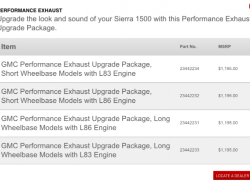

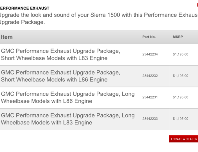

No. Those exhaust kits with those part numbers were new for 2016 year, but will fit 2014+. There are a completely different set of part numbers for the Borla by GM exhaust. The 8 numbers I posted on the front page, the Corsa made ones, are Double and Crew Cab only. The GM/Borla systems cover all the cab configurations and have two different exit designs (dual split under the bumper, and dual out of the passenger side). The GM Performance system (the Corsa ones) are only single pipe with passenger side exit.
OK....but this screenshot has been saved to my phone since before I bought my 2015 All Terrain, well before the X Package was even announced.

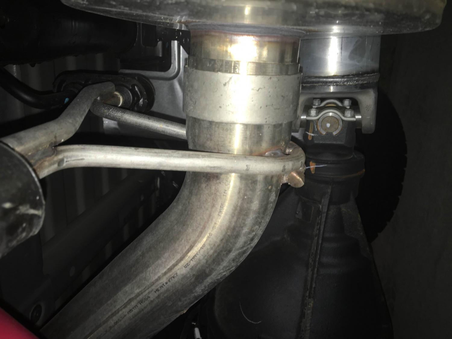

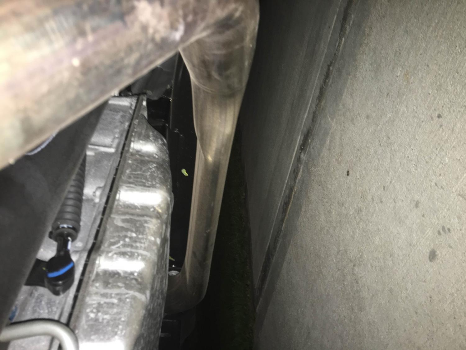

Could your do me a solid, and crawl under the truck and just take pictures of the whole thing? like cats all the way back? perhaps a measurement of how long the muffler is too?
My muffler is the size of a small radiator!! SERIOUSLY ITS 28+" long
Here are pics of my exhaust, sorry the site is flipping my photos however it pleases

I notice it looks like the single exit tip clamps on. Makes me wonder if one could put the dual side exit corsa tips on that exhaust.

I dont have the helicopter sound on the truck. but then again it only has 200 miles. I called the dealer and asked about the performance exhaust and told them that I think mine is just stock. I emailed the pictures to the service guy to see what he thought. his exhaust guy is not in till monday :(
You would have the helicopter sound at any mileage if the flapper is removed. Check and see if you have the muffler, followed by the flapper, and then the resonator. If you do than you have the stock exhaust.
No flappers that I can see. I dont see how this is called a performance exhaust when the muffler is the size of a water heater.
Thank you for the pics. Yeah you have the performance exhaust for sure. That muffler is a straight through design that is Corsa's touring muffler iirc. The size is probably used to keep the sound down while not hurting performance.
