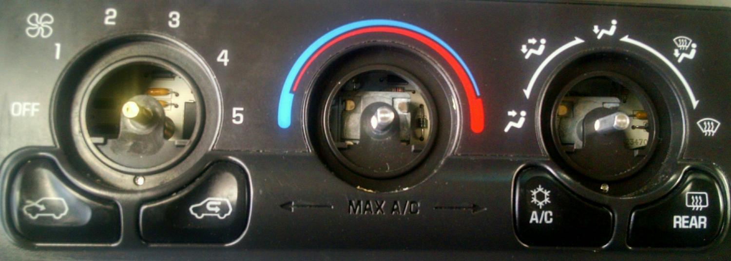

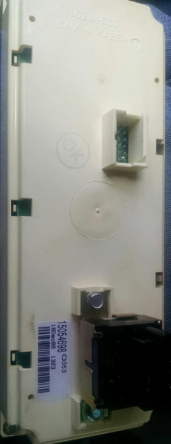

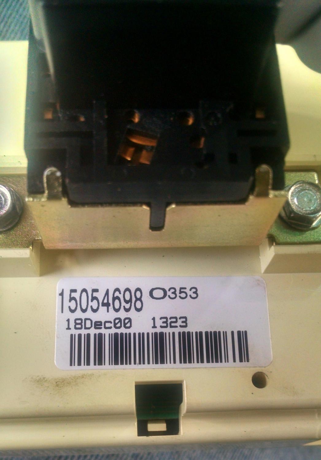

Thanks Tom but I have the manual climate control module, it doesn't have the temp based control the temp selection only moves the blend door to a set position based on were I have the knob set, I took the climate module apart today looking for broken leads or obvious damage but found none, it looks like they may have it designed to control to acuators position based on which one of 2 grounds is active? the acuator is really difficult to access I had to remove the entire top of the dash, the passenger airbag, just to reach it. I am going to try grabbing a used module from a upull it since new ones are no longer available and rebuild ones are insanely priced $150+ I hope it fixes it! I really don't want to to pay the local dealer to scan it with a tech 2 just to figure this out! I wish there was a shop in my area with a tech 2 scanner to get into the climate system for a resonable price, but we're I live there are only a few garages for the whole county that can be trusted our ac guy is booked for 3+ weeks and he's the only ac place that has a recovery machine not that I need one now :), I was hoping someone here had the same issue before and can tell me were to look for the problem?
here are a few photos of the module front and back the large connection is for the fan (this does not exist on the automatic modules) the other is for everything else

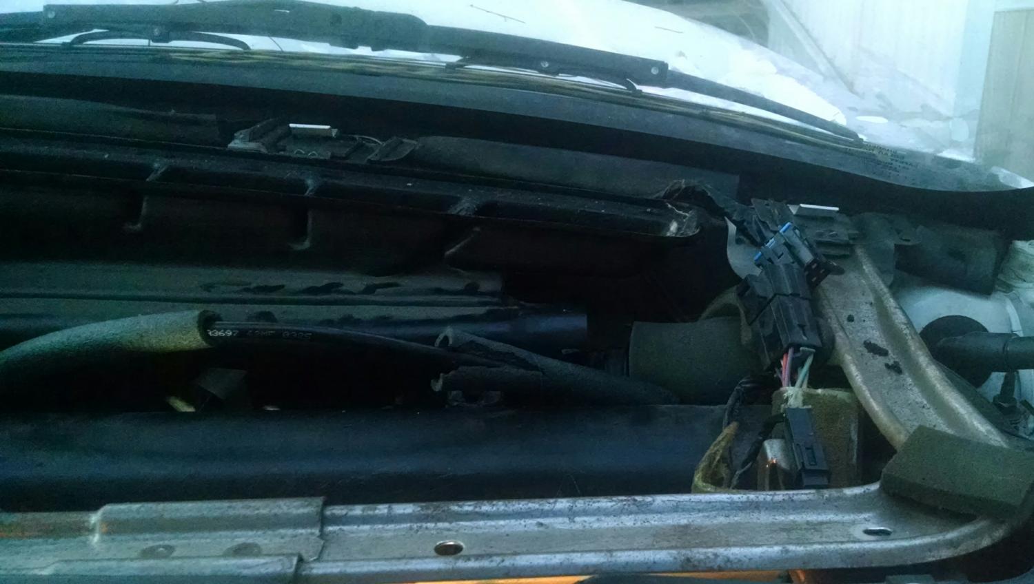

this is the best I can show of were the acuator is located in the dash you can't see it but imagine about 3/4 toward the windshield and about 7-8 inches down and 18 inches from the passenger door down in that dark abyss is were it resides. under the defrost duct it was not something I was looking forward to at least if I have to take it to the dealer I can tell them it's not the acuator so they can't charge me 10 hours labor tearing the dash apart.
