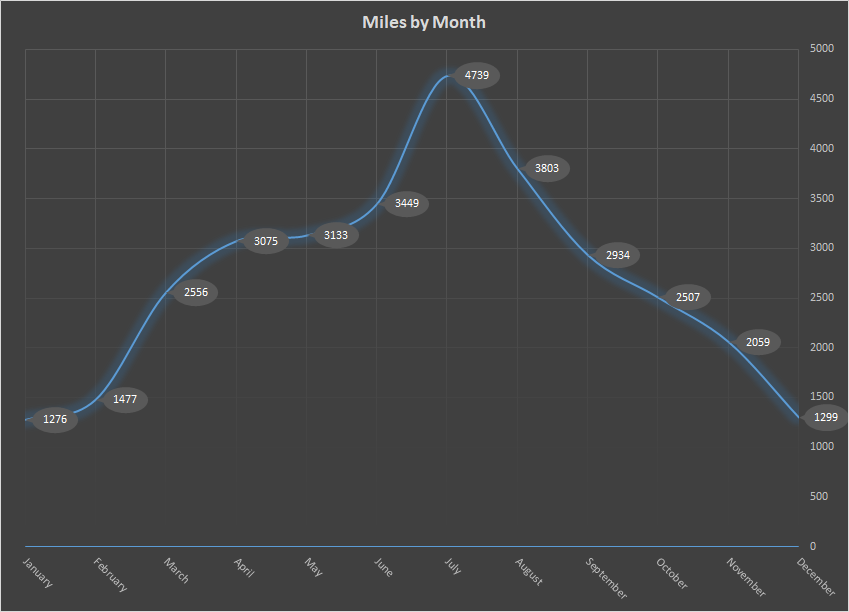

Just an interesting little graphic of the number of miles per month I drive Pepper since I bought her.
My pattern is driving the most miles in the third most efficient month. Hum....
Spend some time having these a look and the conclusion I draw is that mpg is less a function of fuel and more one of climate. In October for instance this year 7 of 9 tanks were as high as her lifetime average, a full 2 mpg above the combine October average. Roughly 10% higher.  Winter fuel in an unusually warm and windless October produced September like results. Good to know.
