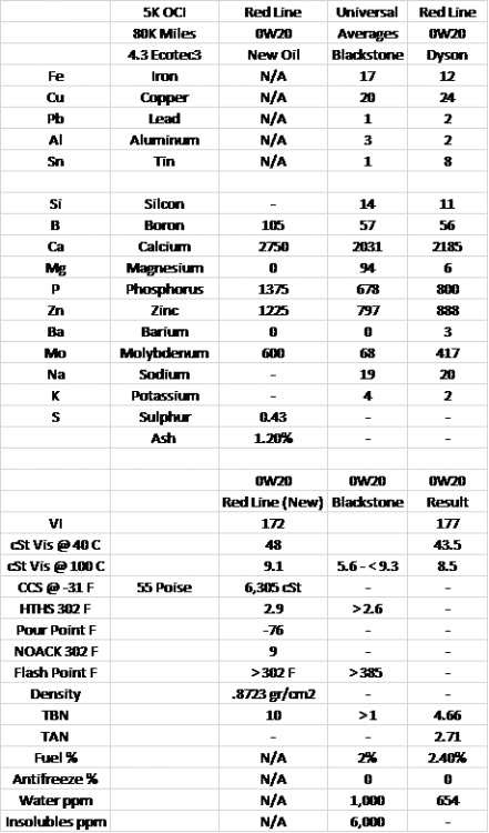

Continuing to add to my library I've added NEW oil analysis and some more physicals. Old sheets will be deleted from this thread.
Did you know that water at basically room temperature has a viscosity of 1 cSt? Look at light oil HSTS values and shiver. :sigh:
Note oil viscosity at -31 F. More viscous by a factor of 700 than at 100 C (212F)
This is SAE zero weight spec! Any more questions as to why 0W* gets better mileage than 5W* ?
It isn't what comes after the W that matters.
