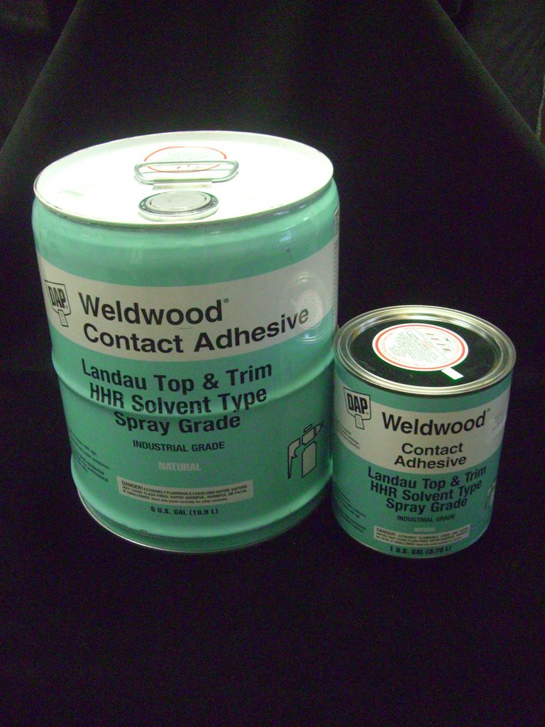

SpartanAutoworx Posted November 2, 2016 Posted November 2, 2016 I do a lot of gm truck headliners and the best thing I have used is this top and trim. Spray it from a cheap gun from harbor freight.
