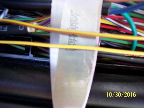

I got one picture then my camera's battery died. I was wrong, there are actually three tan with yellow striped wires.
These are the two identical wires that I tried to no avail.

That's what I had in the picture above. That didn't work either. I didn't show the larger grey wire because my battery died. I'll check the wire colors again later today when I get some running done. Stay tuned.

There are several small tan wires with yellow tracers or some could be yellow with tan tracers. Hard to tell them apart. The larger tan with yellow tracer is definitely just that. The yellow tracer is much narrower than the tan.
