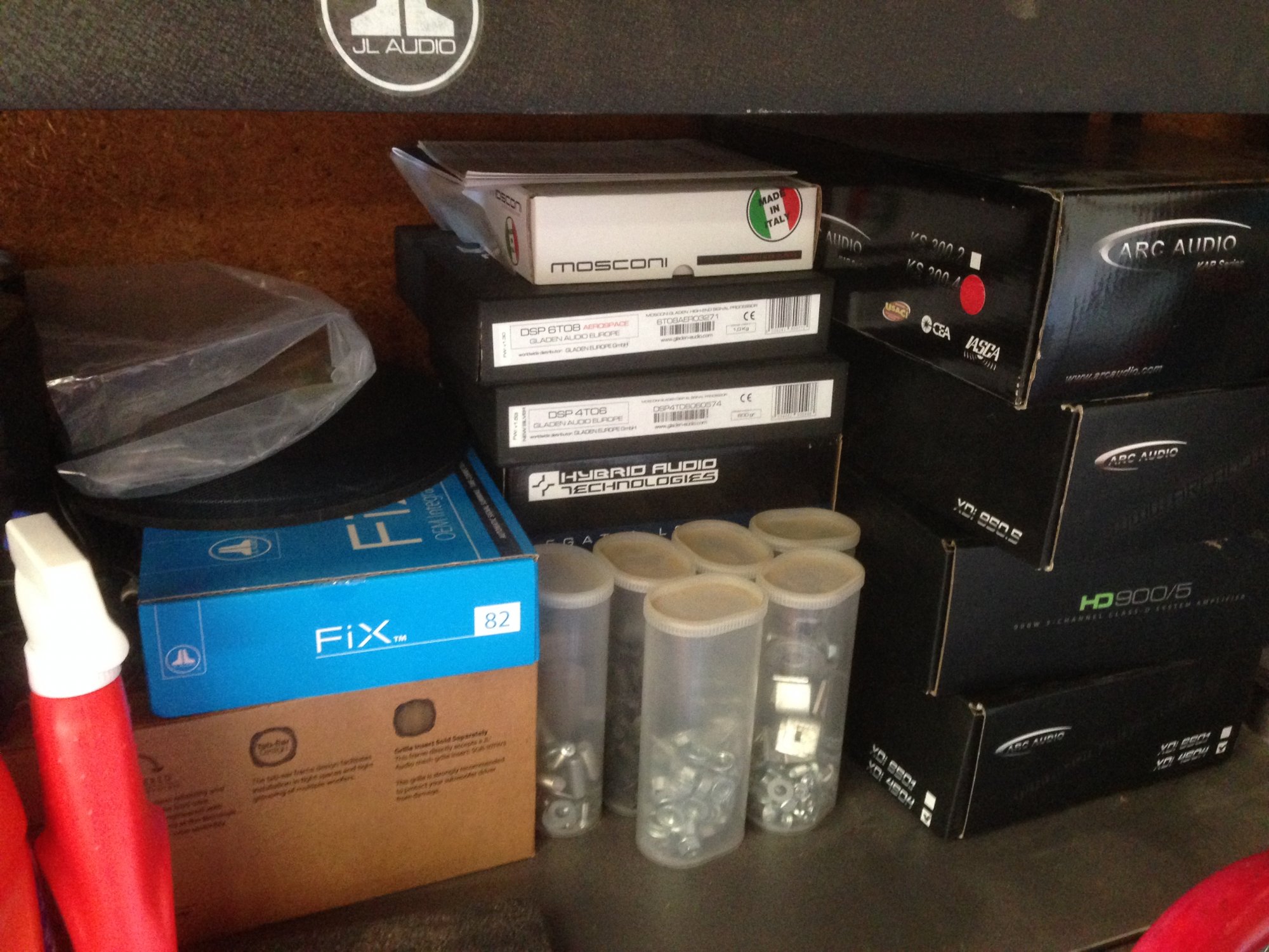

Sweet and that was how I originally thought of doing but I was going to use rear fill so I planned to put one of the top dash speakers under the dash for chimes etc.  BTW, if you are interested in Mosconi I have an extra 4to6 and 6to8 hanging around.

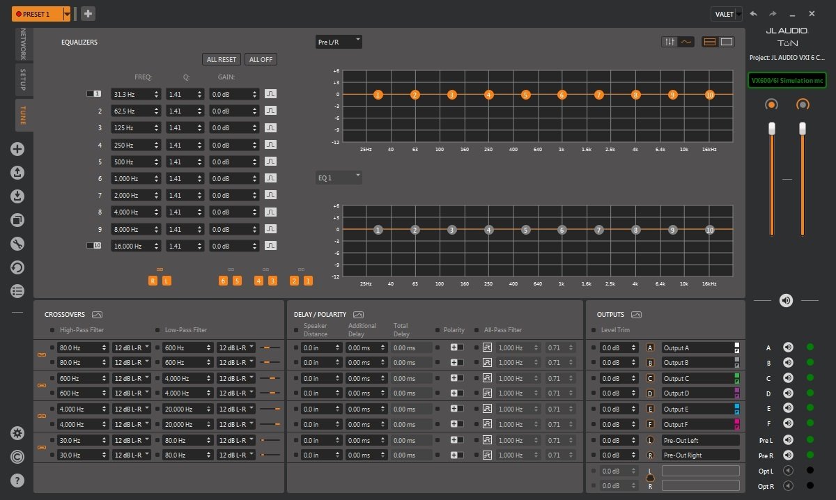

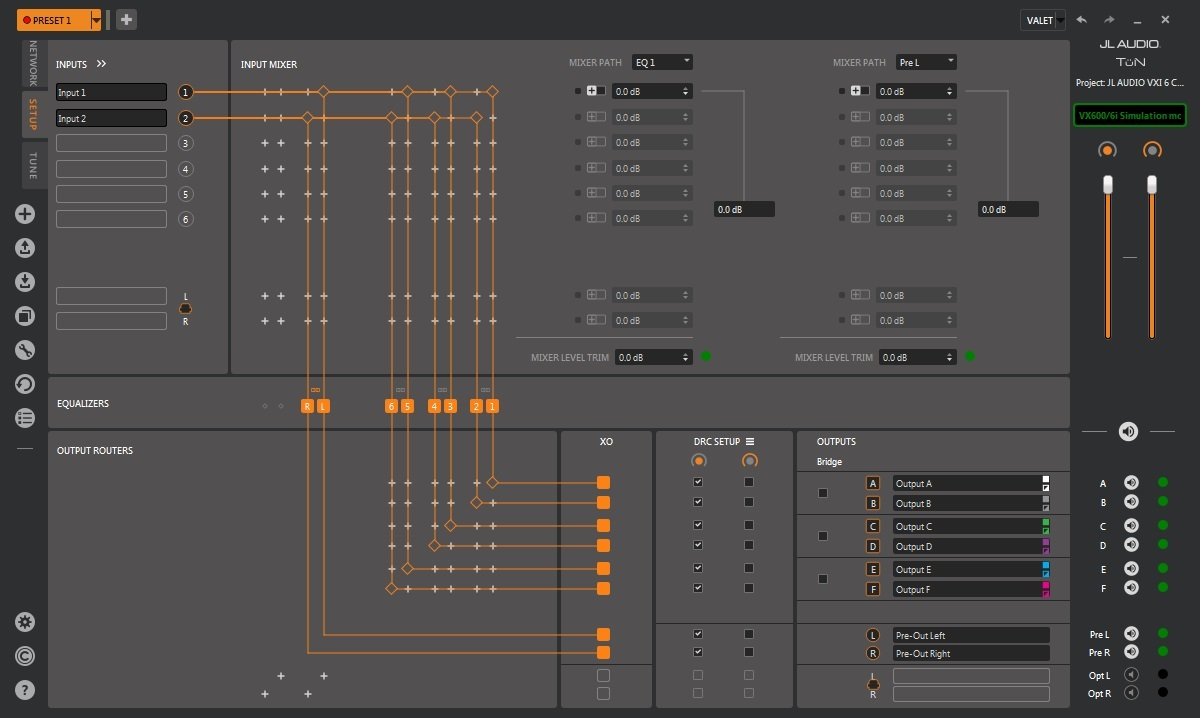

I was messing around with the desktop version of the JL Audio DSP and it seems like it's going to everything I need.  The Preamp outs are actually separately configurable so the amp acts like a 8 channel, with 6 powered channels and 2 pre amp channels.  Perfect for what I need right now.
