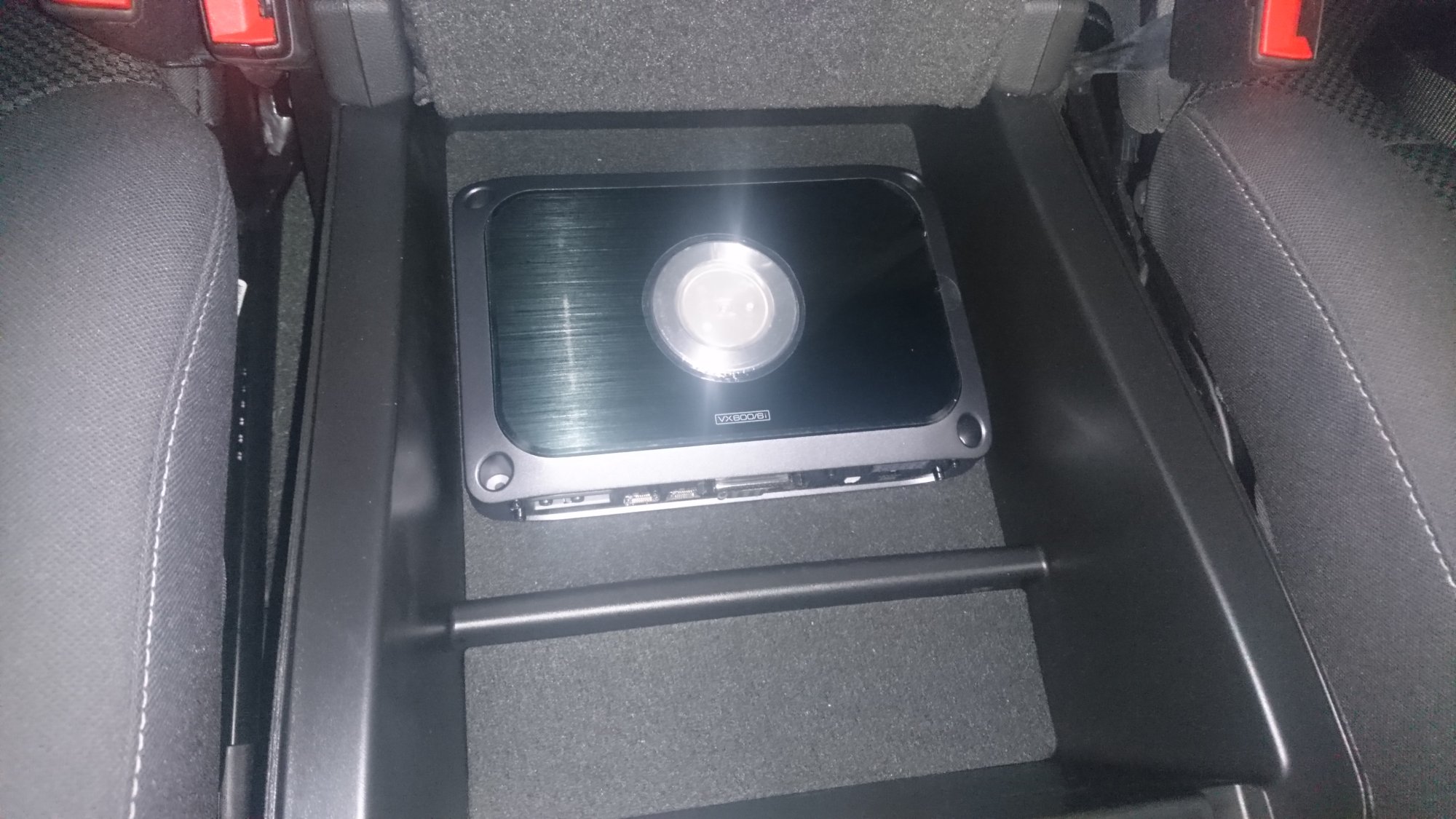

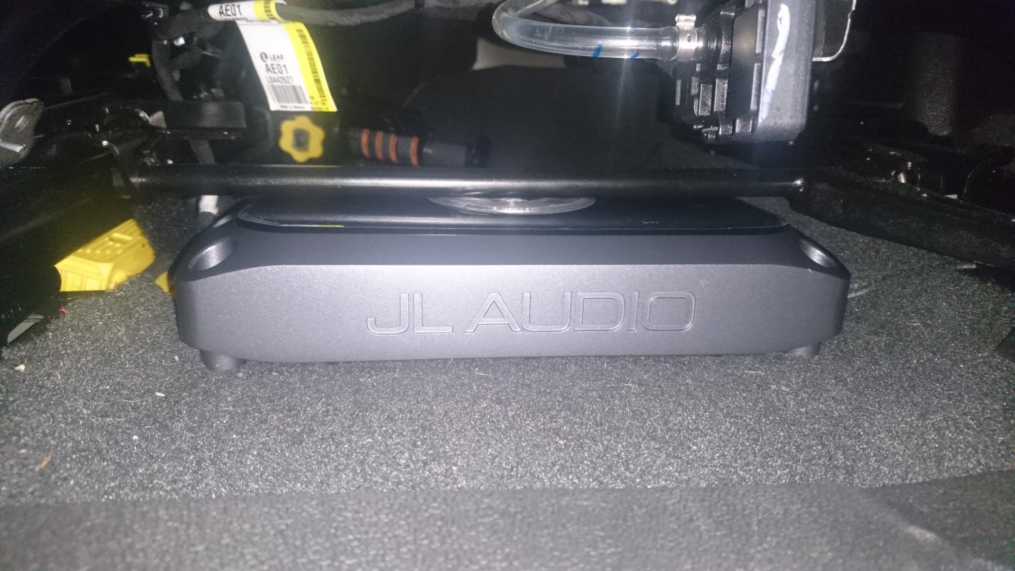

So I ended up getting the JL Audio VX600/6i because it best fit what I need as a all in one unit. It fits in the console but not sure I'm going to install it there. It's a little too tall to fit under the passenger seat but might work if I cut the carpet out. I may just mount it to the back wall behind the driver's seat. We'll see.

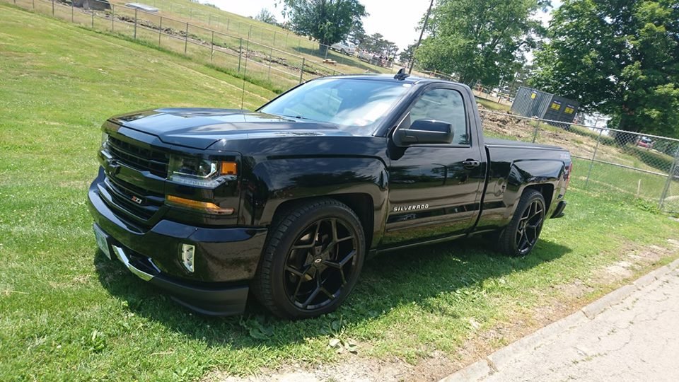

Just a pic from the car show today
3,500 miles.

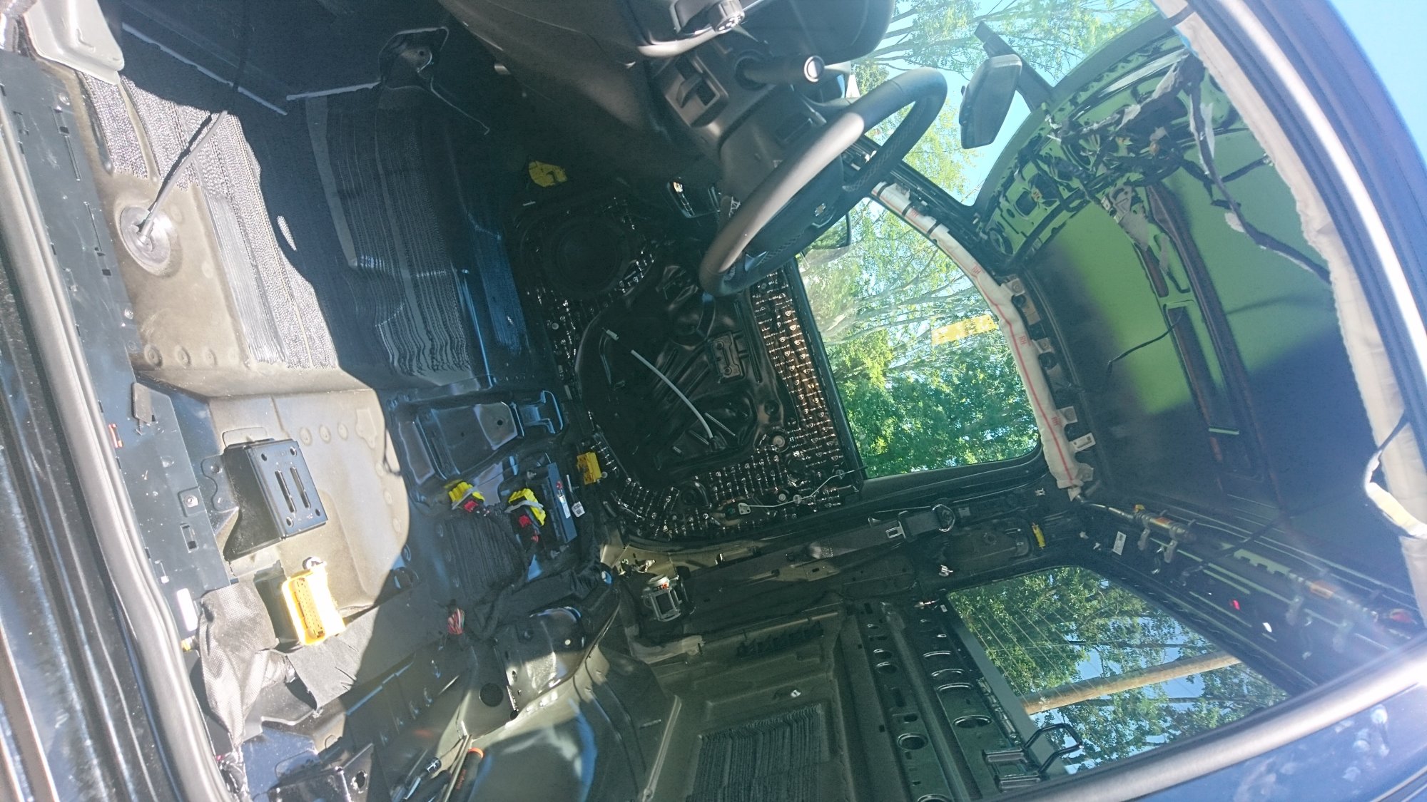

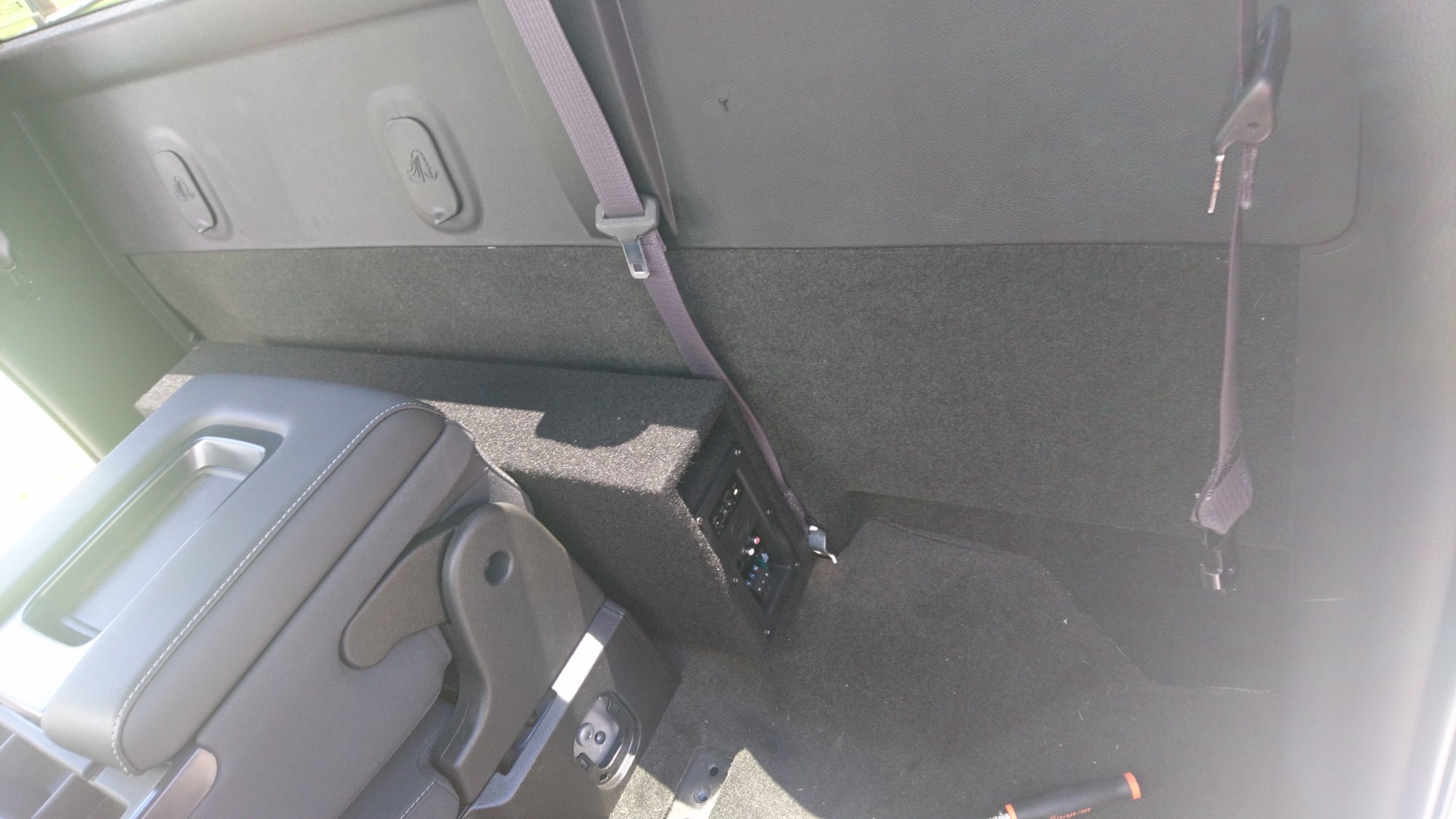

Test fitting my sub as I gut the interior. I think I'm going to try rear fire, there's a good 3" between the subs and wall if i remove the carpeting and insulation. In these pics the box is in front of the stud for the spare tire tools. I'll probbaly leave the stud there so I can bolt the box to something.
Edited by qwank
I have problems already, I just noticed looking at the pics I never tried to flip the jumpseat up, sure enough, it won't flip up with the sub box there.  if I push it against the back wall firing forward it will, but it's a little too long and won't fit once I put the middle seat belt back in.  Back to the drawing board.... :shakehead:
Single sub is best or switch to a center console
