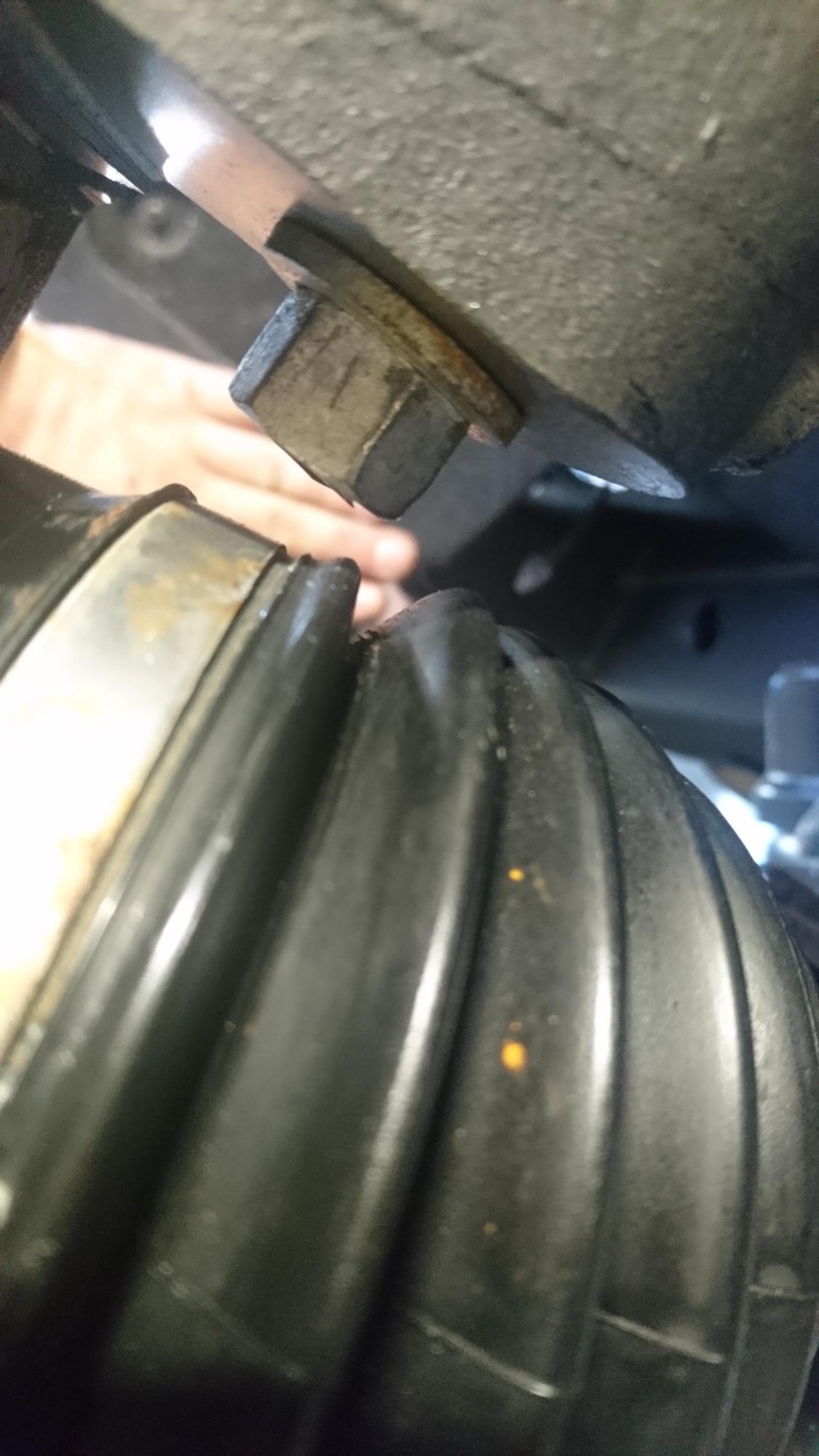

I did the right side first to make sure that my axle was going to clear the drop struts and make sure everything else was going to fit. The top ball joint stud was really close to the front axle boot so I had to cut 1/4" off the stud. The instructions said 1/4" to 1/2" but if you do a 1/2'' there's no way there there be enough threads for the nut. They are a little shorter than I am comfortable with so I may get a shorter nut if I can find one.

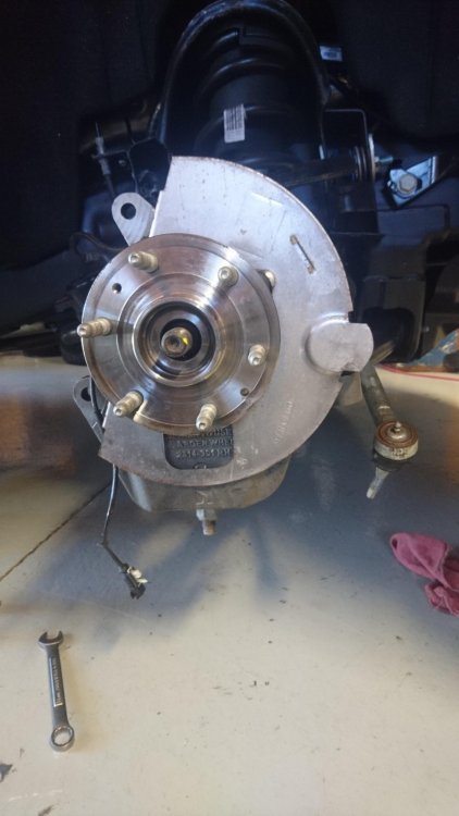

Here's the Belltech spindle next to the stock spindle.  frontdrop1.thumb.JPG.66f5cf93d6934715b1ce735d54ca9e9c.JPG
Here's the spindle on the truck.

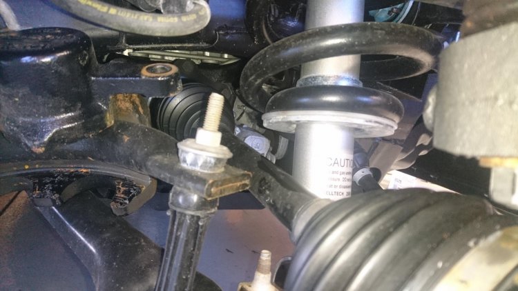

Here's my axle clearance
And here's the before and after of the upper stud to the axle gap.

Looks like you have plenty of clearance with the upper ball joint.
