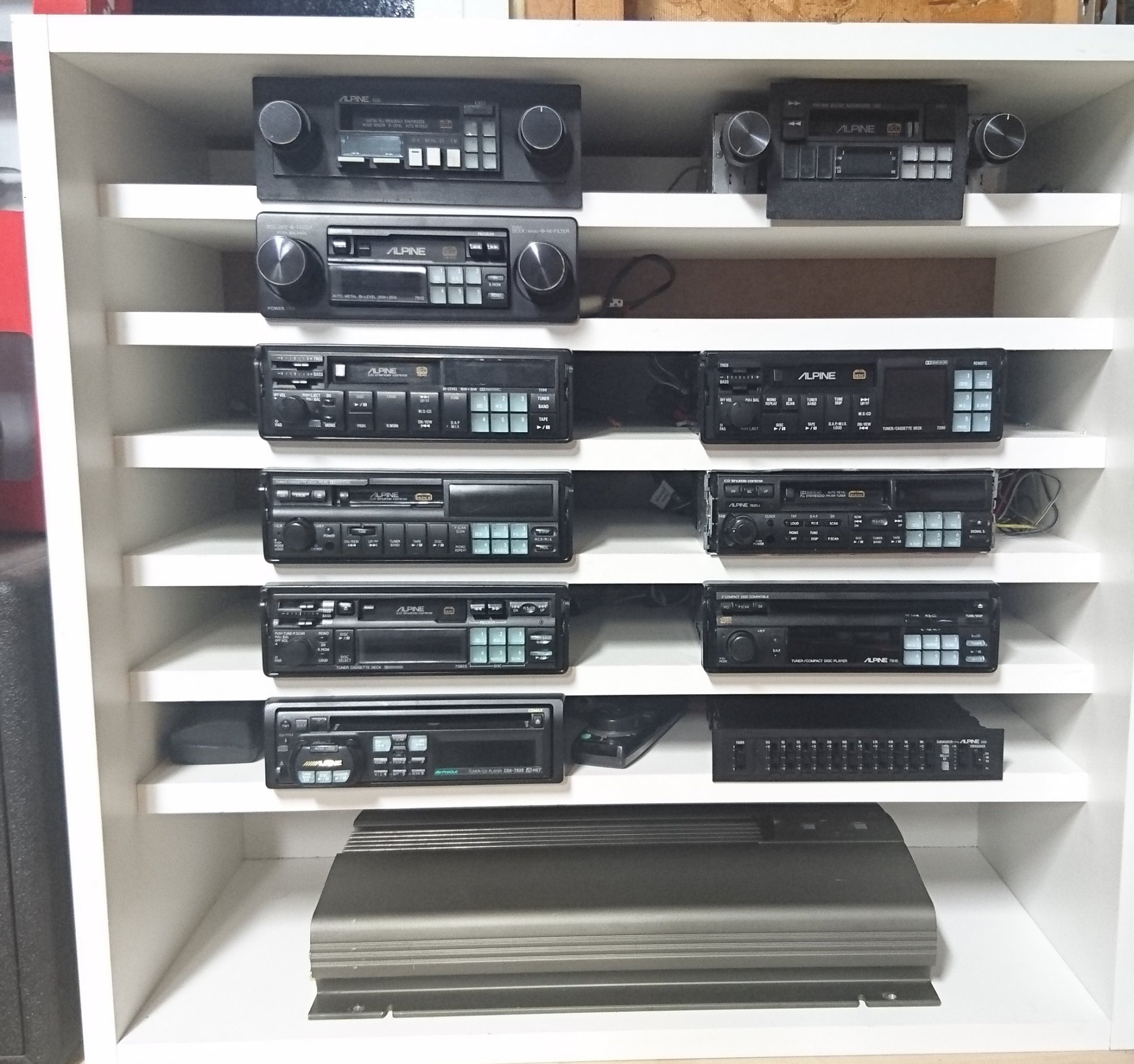

Hahaha! I've been using Alpine almost exclusively for 20 years.  Here's a picture of some of the older radios I've collected over the years.  That amp on the bottom is a class A from the early 90s that's going to be going in my Corvette.

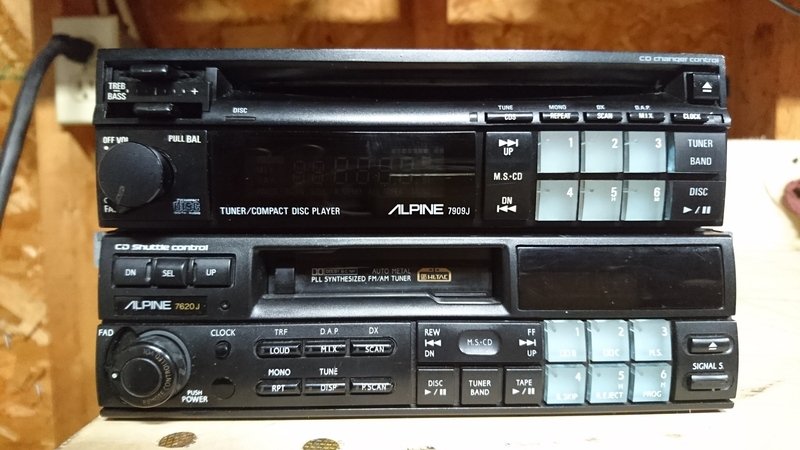

Here's the famous 7909J with it's cassette equivalent, 7620J
I kinda gagged a little. I have a sundown amp collection like that
