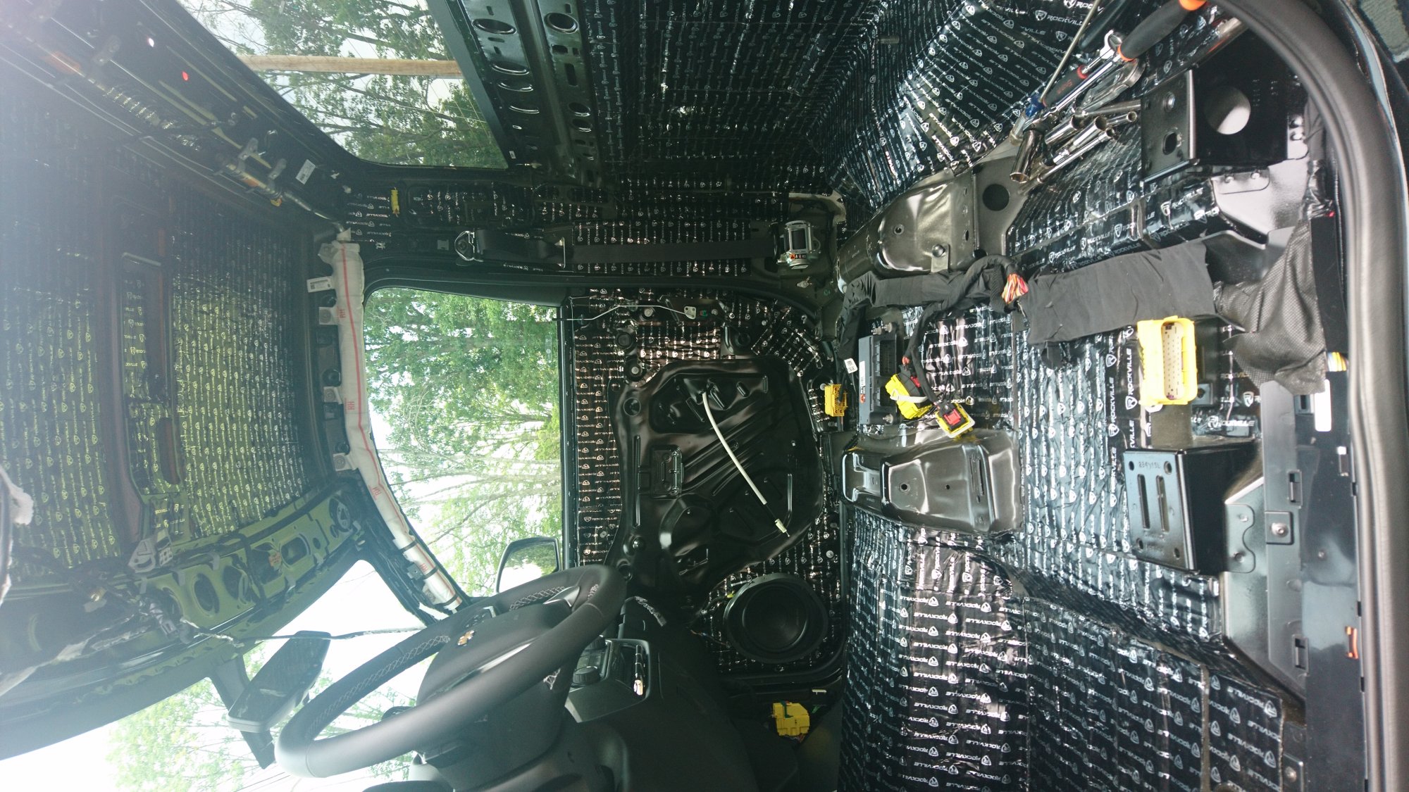

Getting there
Looking good!!

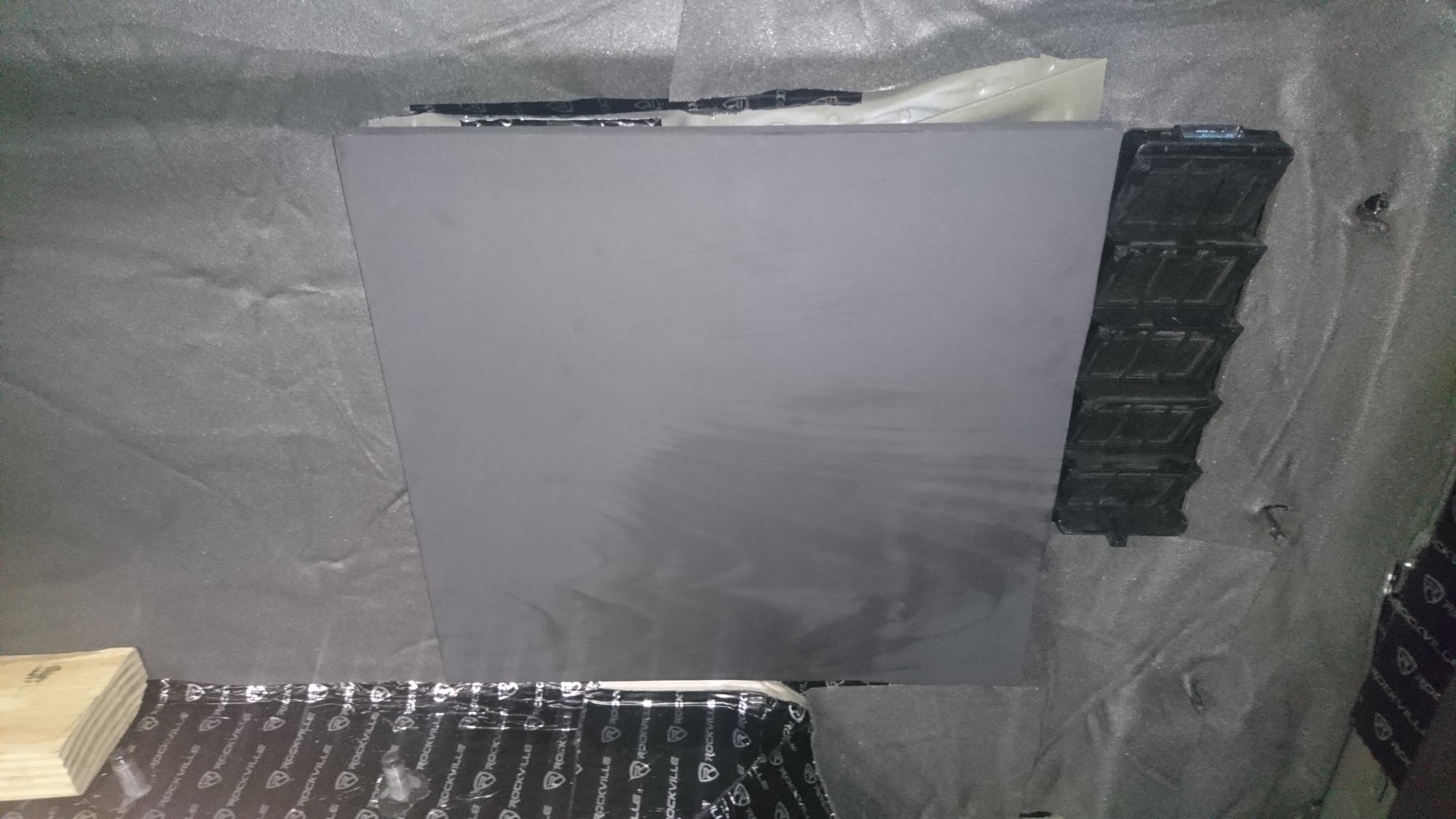

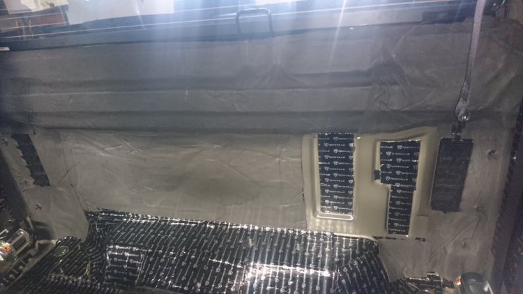

I finished the deadener and started installing the ensolite on the back wall today.
I also finished putting spray foam in the front and rear gaps of the ceiling. I didn't go too crazy around the 3rd brake light, I want to be able to take it out when I need to.
When I ensolite to doors, can I just put it on the back of the door panel, or does it need to go on the door itself? I feel on the door it will just get messed up if I ever need to repair anything in there.
The uncovered part is where I'm going to glue the amp rack.  I decided on putting it on the back wall.
Edited by qwank
I usually put put ensolite on all horizontal panels.  Doors and rear walls.  Inside doorskin
