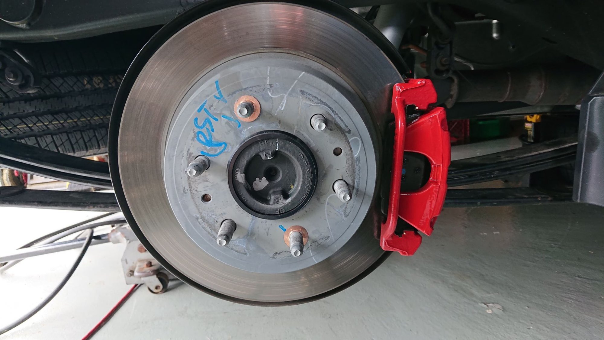

Nothing really too exciting going on right now with it except I painted my rear calipers red for now until I do the rear brakes.

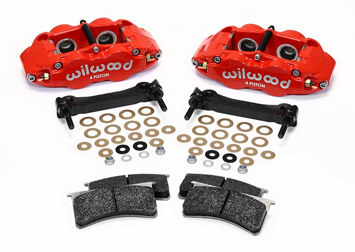

I did get my brackets in that will allow me to run C6 Z06 rear calipers on the back.  They are made to bolt on to 14'' rotors.  Our stock rotors are 13.6''.  I really don't want to spend $500 for a pair of 14'' rotors.  I also really don't want to run those PBR Z06 brakes with the individual brake pads for each piston.
Here's what I'm thinking:
The Corvette Z06 rotor is 13.4''. The brackets move the caliper out 0.6'' to fit a 14'' rotor.
The Corvette Z51 rotor is 13.0" Wilwood sells a direct fit 4 piston caliper for Z51 that uses the stock rotors.  I should be able to  use the Wilwood caliper with these adapter brackets and they should perfectly fit the stock 13.6'' rotor since it moves the mounting points out 0.6''
So that's my plan.  I probably won't do it until the spring/summer.  So for now the rears are painted.

Here's the Wilwood Calipers I plan on using. the mounting set up should also allow me to shim them out a little if I need to:
And here's my rear brakes as of right now:

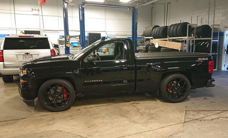

It rained for a little bit today while I had the truck at work, But I had some nasty trash to throw away and I didn't want to stink out my Blazer.  Snapped a pic with the red calipers when I brought it into the shop to adjust the tire pressures and have a small scratch buffed out.

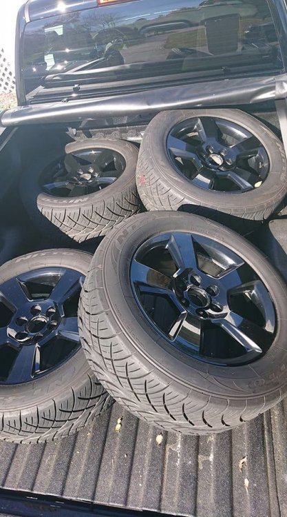

I found someone local to me who wanted to trade my stock 18''' Z71 wheels and tires for these 20'' wheels with 305/50R20 Nitto 420s.

I like the polished ones too, but I'm surprised I found someone so close who wanted to trade so I'm not complaining. These should be good track wheels.
